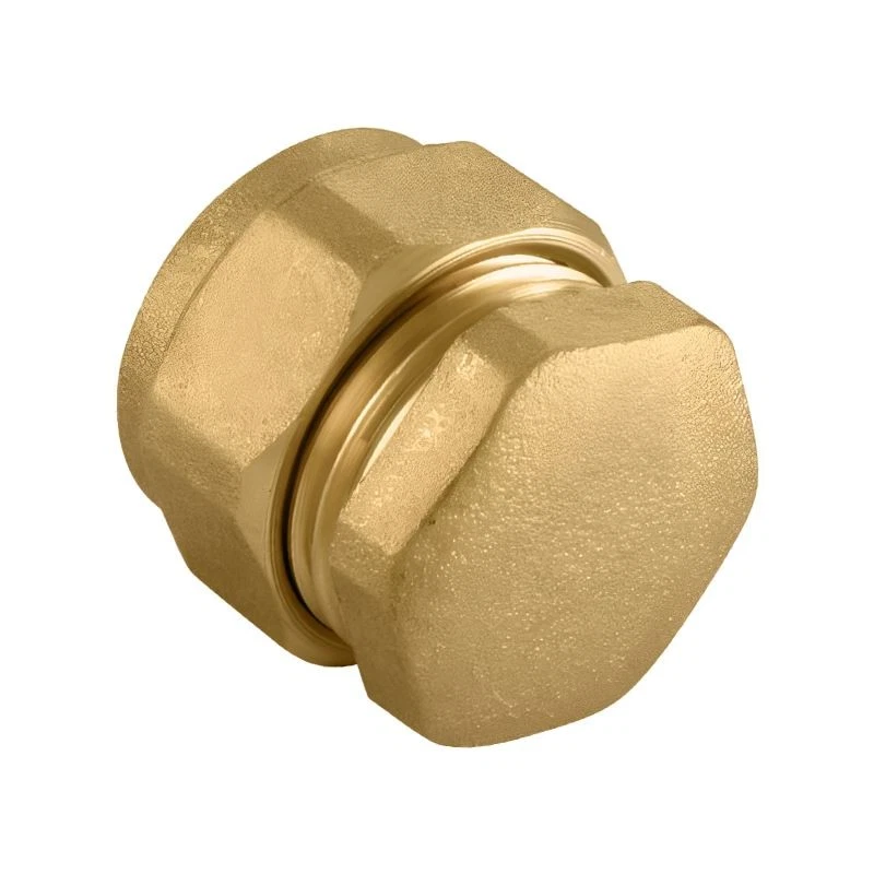

and you'll need one of these

b) Ideally you should remove all pipe work back to manifold and fit blanking nut.
