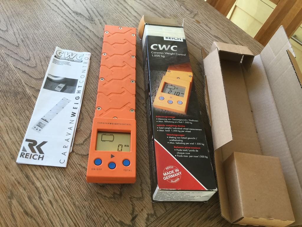

Reich heavy duty caravan / motorhome scales, 1500kg variant.
Obanboy666
5,070
5,333
As above bought 2 years ago when I had my Swift c class that had a low payload. I now have a pvc with a payload I will never exceed so scales gathering dust in a drawer.
These are the heavy duty 1500kg variant suitable for even the heaviest motorhome.
Accurate, confirmed by local weighbridge within 20kg.
I found to ensure accuracy placing 3 wooden plates the same height as the scales under 3 wheels with the scales under the 4th wheel ensured the vehicle was level and ensured an accurate reading.
I will post at cost or buyer can collect from Teesside.
£90.00 ono.

I got within 10kg of the weighbridge Steve, I also use the 3 wooden slats to keep the vehicle level.
Very handy to have if you are unsure of your weight.

Just wondering how accurate weighbridges gave to be? 1% of 3,500kg is 35kg - your scales might be every bit as accurate!
And the public weighbridge I've used once or twice is not on perfectly flat ground, so the total vehicle weight will be ok, but I wonder about the error when weighing one axle?
Before I make my brain ache thinking about it - what sort of errors did you guys get when not using the levelling slats you mention?
I know I'm sad, but googling on public weighbridge accuracy suggests that 40tonne weighbridges are likely only to be accurate to 10 or even 20kg. If you weigh axles separately there can be an error of as much as 50kg. And anecdotal evidence of people stopped for weight checks is that 5% tolerance is acceptable. Well, 5% of 3500kg is a whopping 175kg! Who'd have thought....

Only ever used them with wooden levelling blocks.
I never tested it against a weighbridge without the inserts Mark.
I got the idea online and it made sense as it only takes a slight angle for quite a lot of fuel and water to shift it's weight. Then I suppose if there is any angle involved, the fulcrum effect could come into play?
