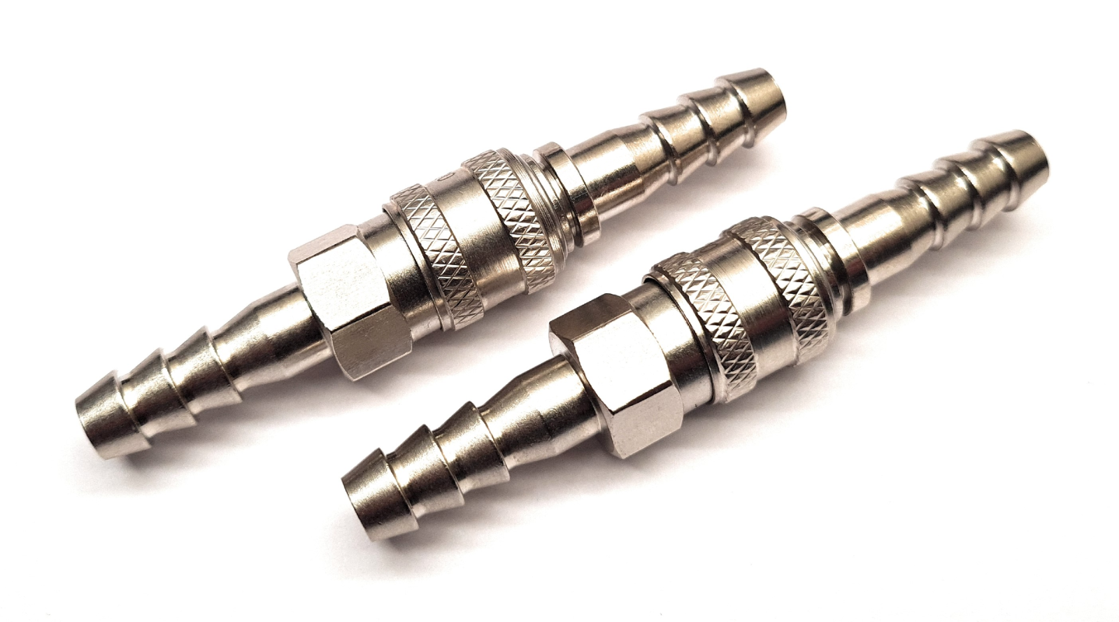

Hi what is a quick release for gas , ? have you got photos mate please.
This, on E Bay and other places ideal for interchanging barbis .patio heaters gas lanterns etc.
Sorry I used them on my carpet cleaning machine and they leek. ok for external barb q's but not for long term in van . I think

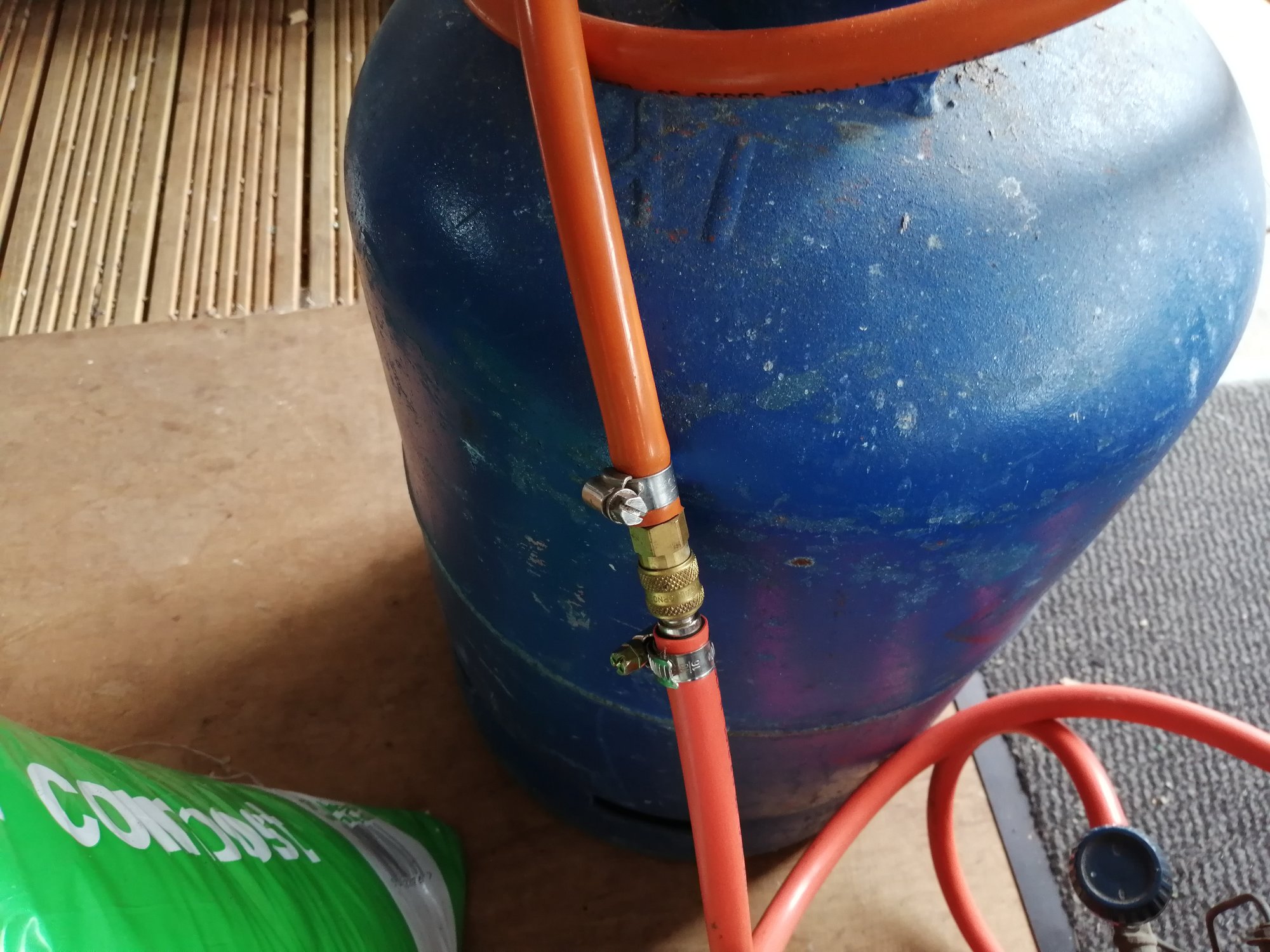

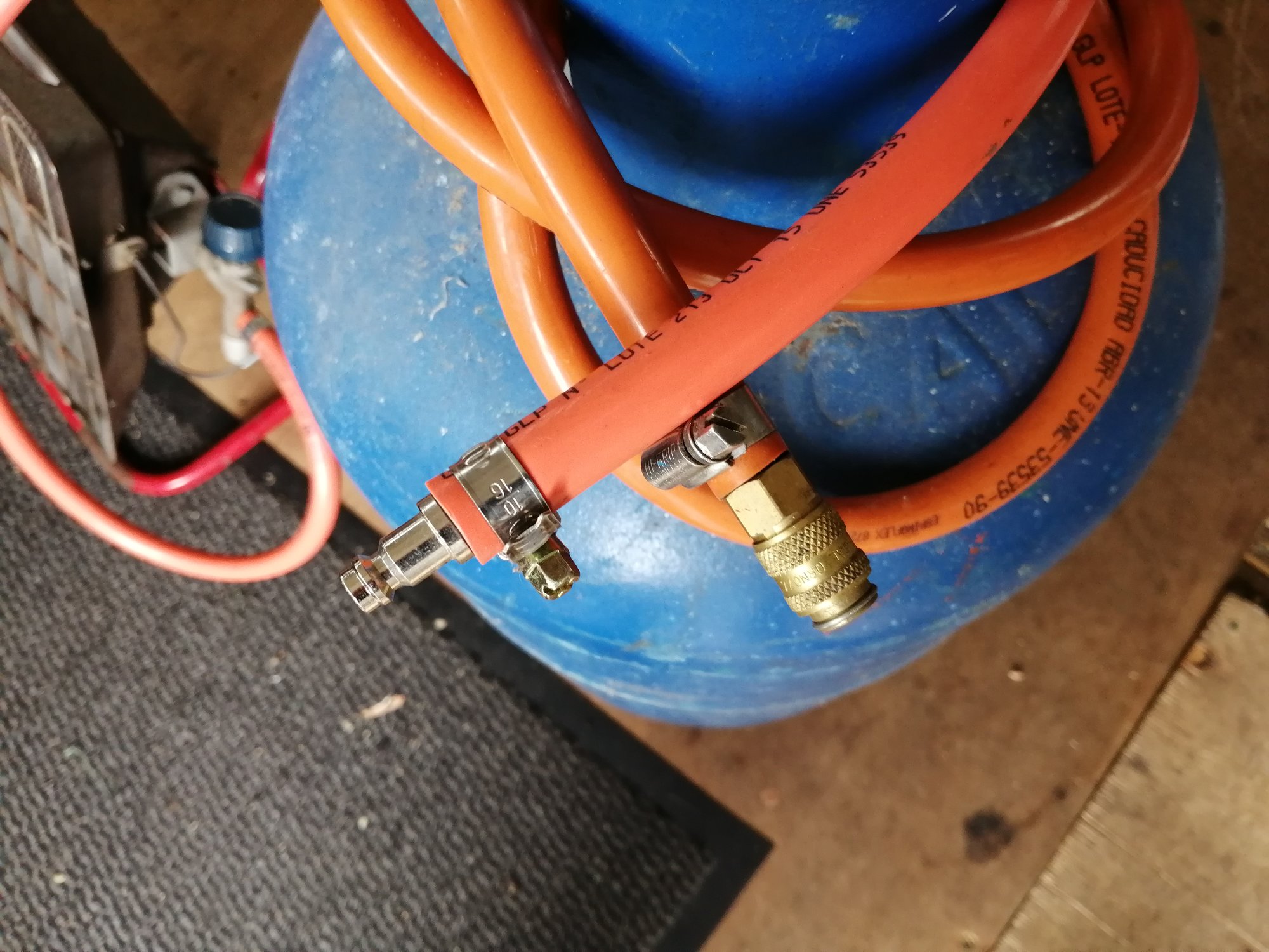

Here is my quick release for LPG quick switch from Butane to Propane too which ever gas you have available, with the correct regulator of course,
shown is my shed set up I have one in my van from the refillables for the Barbi etc.
