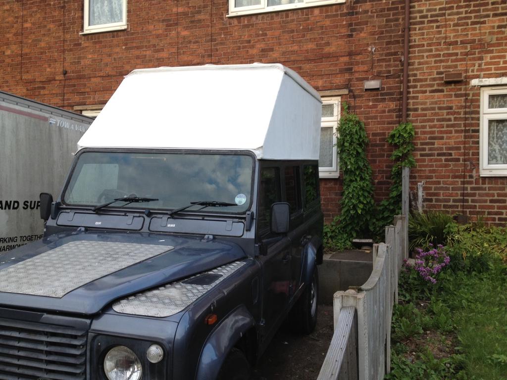

im looking for sumthing bigger than my landrover for using in eurpoe mainly spain. im still going to use my landrover pic below in uk for weekends etc

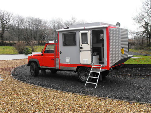

example of demountable on a pick up below

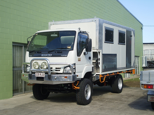

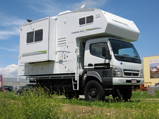

then i thought about a 5 tonne to 6 tonne pick like this with a demountable on top to sole the weight problem and have a bike rack behind
such as this
problem is it becomes a vehicle over 3.5 tone with alot more expanse of taxing mot and an awful lot more on insurnace.

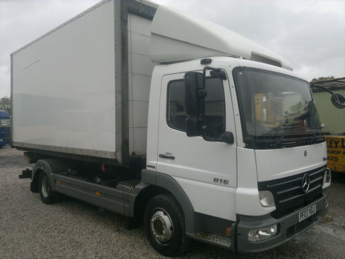

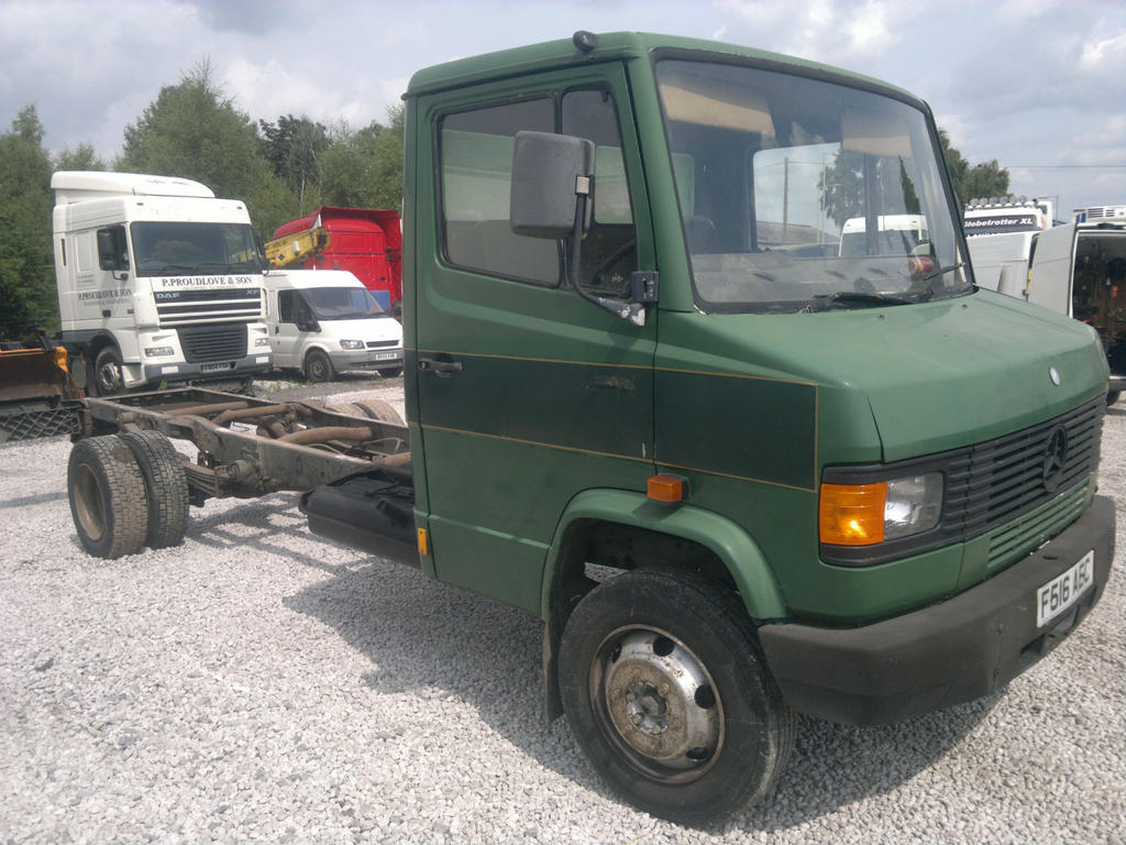

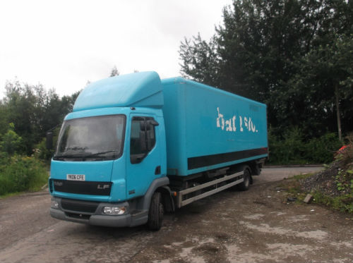

so having looked at the info on how to turn a vehicle into a m home what would be the issuies with just apply for the 5-7 tonne pcommercial chassis and dmounatble as one unit by bolting it down as part of the vehicleas appose to straps and being part of the vehcles load as a demountbale.
for eample are the following vehicles classed and insured as m homes or commercials
thoughts welcome
I would have thought that a fixed down demountable would be classed as a motorhome. If you use a business vehicle for business in the week and then with a demountable in your leisure time, then I would have thought that you would need 2 lots of insurance - don't know for sure though.
Love the vehicles you have pictured, especially the Fuso and the Landrover, but you have p*ssed my missus off as you have got me started on demountables again!

i like you think rob if its use for just private non comerical use and fixed on with bolts it could be classed as a m home as you know rob sum demounables mainly th usa artic fox and lance campers have acces point to the cab. it makes no mention of the dvla stuff that you have to be able to acces it from the cab.

also rob what do you think of converting sumthing like this its a 7.5 tonne with a demountable body you seem to et a lot of vehicle for your money

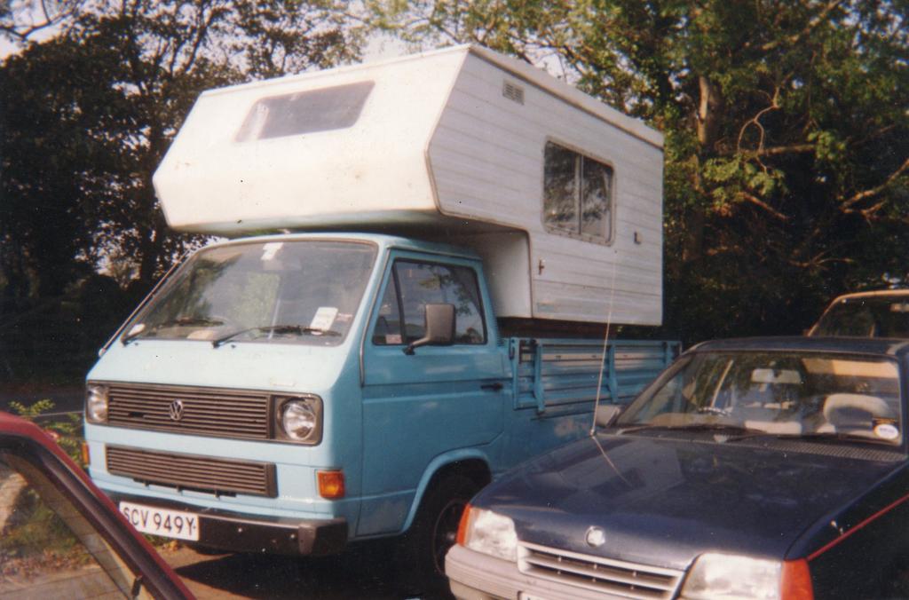

i used to have a suntrekker on a vw pick up. it worked ok and you still had a big under pickup bed locker img009.jpg
mind these demounts are getting expensive now .
