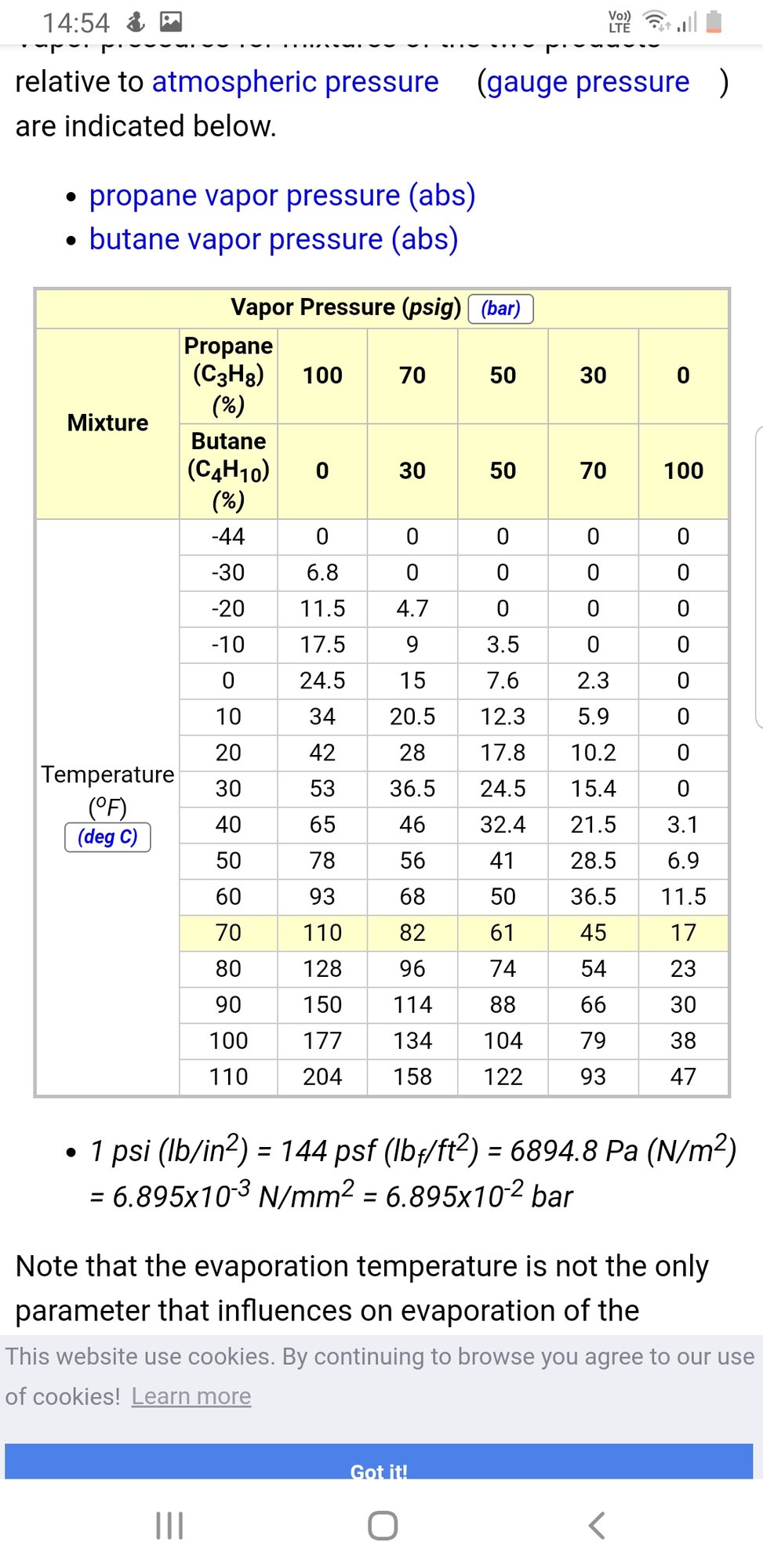

Here's a screenshot of relative vapour pressures - temp is Fahrenheit.
At 60⁰ propane gives 8x vapour pressure of butane. Of course this is still more than the regulator needs but the evaporation rate is slower as you saw with comparison bottles.
Come warmer weather the butane will be ok and when it's all gone you can change to propane again.
