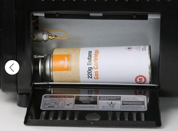

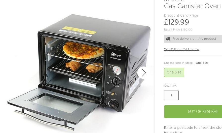

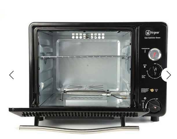

I have one of these ovens from go outdoors,i also buy gas for a pound a canister.
I bought mine when on a offer for £99
Can be stored or fixed,can also be taken out side to cook.
