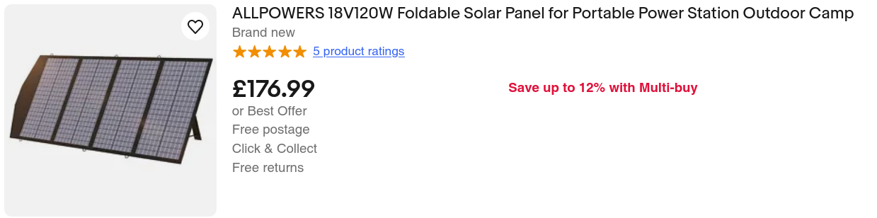

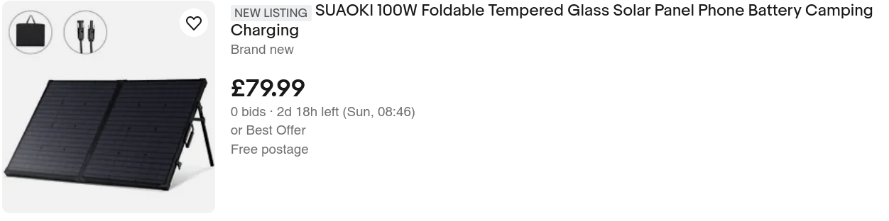

This is the sort of thing I am seeking user experiences and suggestions on. Freestanding stand alone panels that are ground based:-

I use an EcoFlow for additional off grid power and it’s great, but their portable panels are well over priced so I bought 2 of These added 2 hinges, an over centre clip and an handle. Y connector and therefore a160watt folding panel under £220
Like many other products (as I've been finding all this year), they are currently out of stock 😟
Like here.
