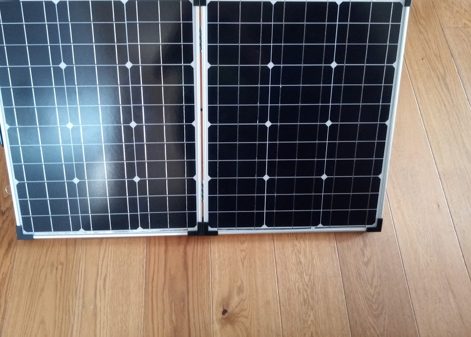

Folding kits arrived yesterday...
For a size reference, the floorboards are approx 18cm wide

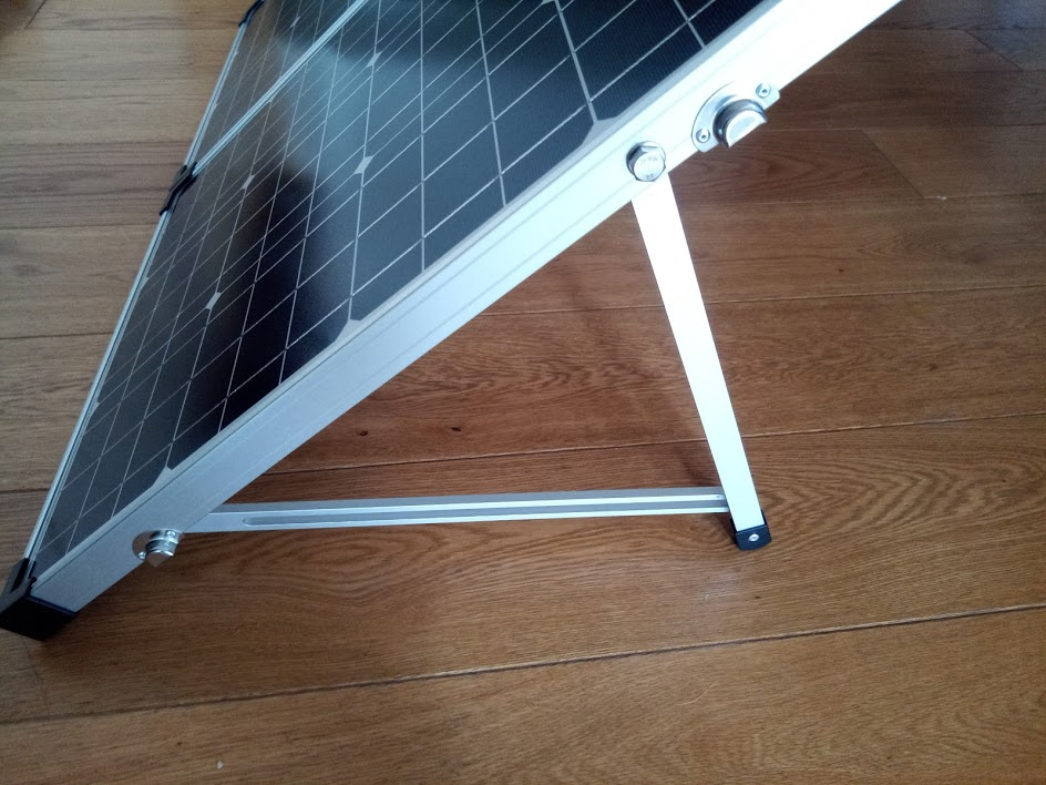

Side view - this is "lowest angle" and you can adjust to go more vertical with the arms (or I guess just lean on something suitable?)

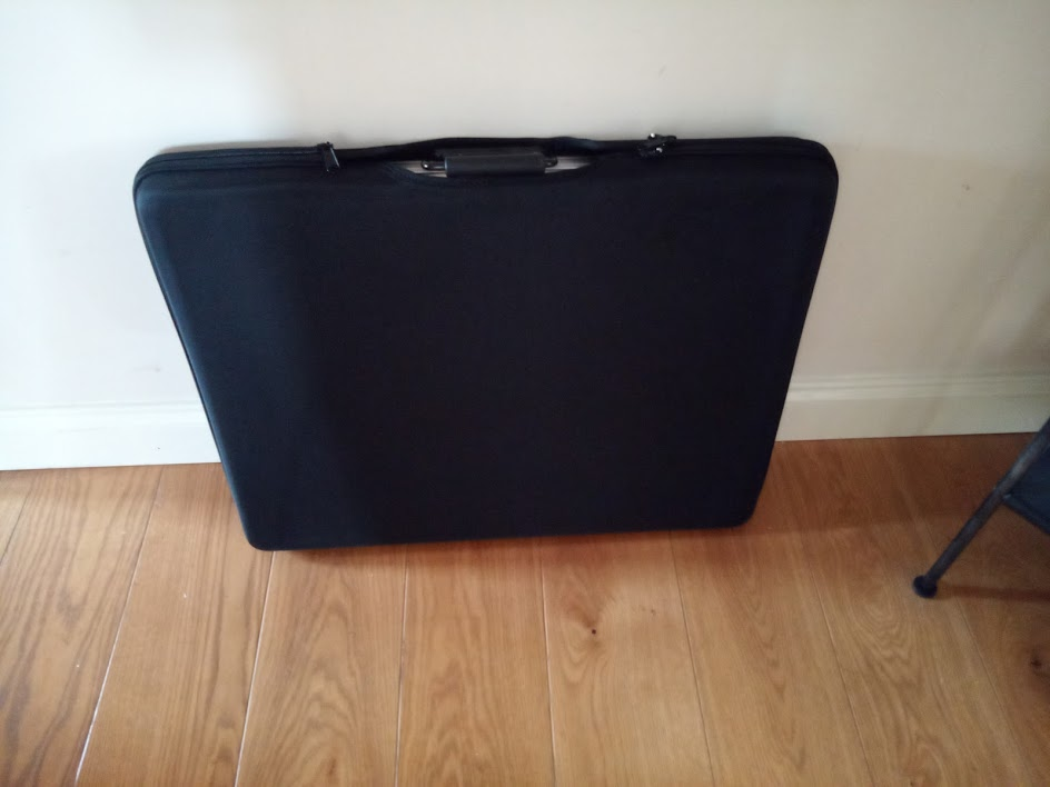

And folded & back in the padded case
I need to examine in more detail to see the best way but I think you could use the securing clip (that does the lock when folded) or maybe the handy to loop a chain through to secure to an immovable object to stop someone simply picking up and walking away with it (always a potential risk with portable panels).
Nice kit dave .
They are. (y)
There is a nicer kit I got for someone last year which was a lightweight folding panel kit and is the same size but half the weight - however that was significantly more expensive :(
Like anything, it is generally possible to improve if you are willing to spend the dosh, but I am well pleased with these for the money :D
