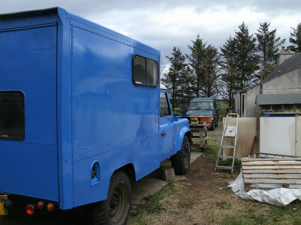

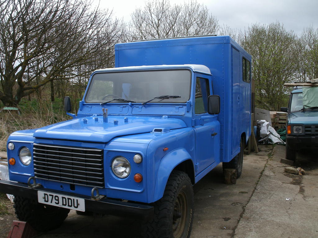

We bought it May last year, needed a bit of work doing, see our web site, build photos,
Finished end of April
