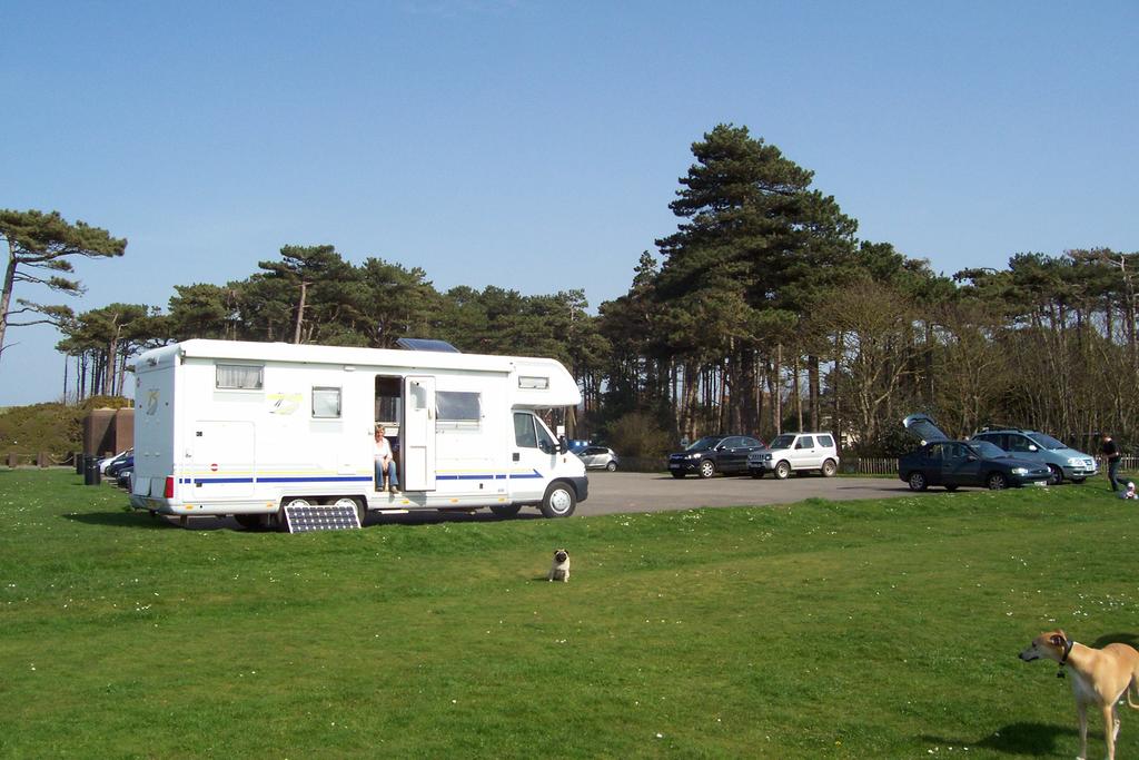

I've never run two axles but after two seasons with twin rear wheels I don't see the advantage of two axles except for a longer permitted overhang. I have a great load capacity (4.6t), a tight turning circle and loads of traction, especially with the fitted diff lock. We also don't get clocked as Class III on French motorways...

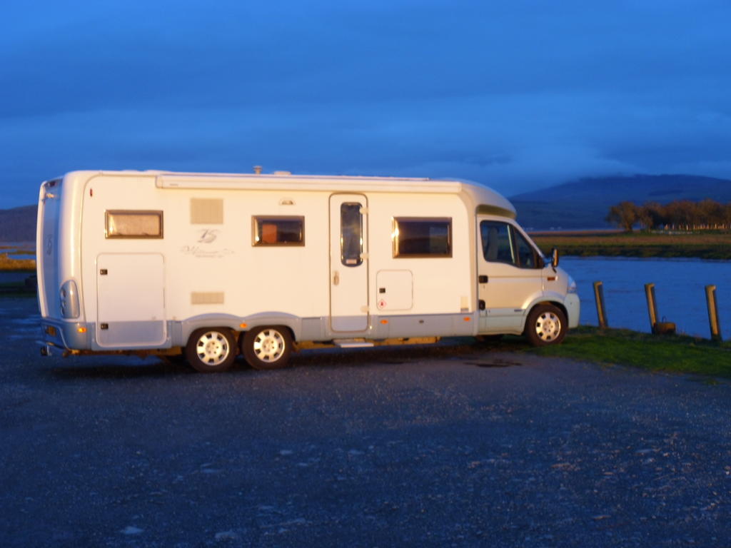

I am on my second Tag Axle van now and they are very stable and the setup gives a longer body and more living space.
We looked at downsizing about 18 months ago but have been spoiled so finished up with another Tag, same length but low profile and better layout.
First one
Present one

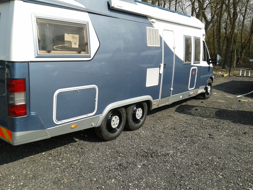

I've had 2 merc based 4.6 t vans...twin wheeled back axle....both vans were a bit bouncy, and they leant a lot going around roundabouts, but I got used to them.

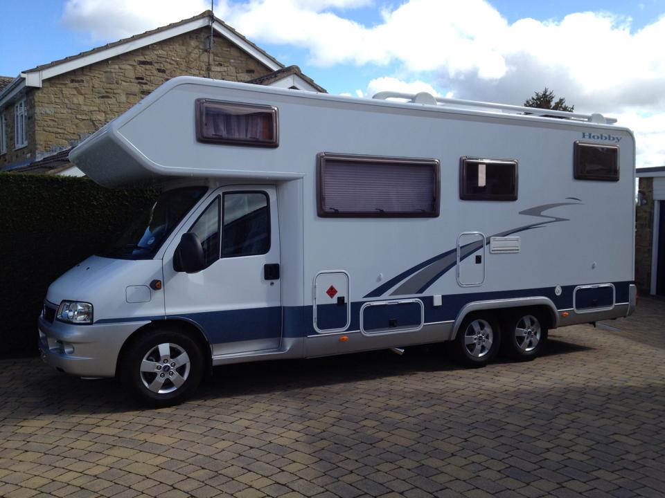

My present van (Hobby 725) has an Alko twin rear axle chassis, gross weight is 5 t, and it's like running on rails...it's so stable. Hardly notice if a hgv overtakes on the motorway, whereas previously the bow wave would push you sideways slightly.
Both axles are braked. It confused my regular (20 yrs +) mot man as he'd never done a twin rear axle van before, but it passed with no advisories.
