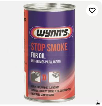

Ex valve oil seals, buy a can of stop smoke and add to oil, my car was doing this and now does not, rings only glase if town slow driving & some engines dont like semi or full senthetic oils, if yours is a older donkey only use standard 15/40 oil.
It will take a few weeks for the oil additive to do the trick.

Yes some do this, but if it happens after a run then valve seals which happens as they get old and harden, stop smoke softens them, worth a try for a tenner a tin.

As already mentioned Ral the first option is to try an additive.
I`ve used Liquid Moly before and found it worked, just follow instructions and add to warm oil.
Moly is a oil inchancer, it wont soften valve guide seals, as i stated above use a stop burning oil additve, it will take a few th miles to do the trick.
