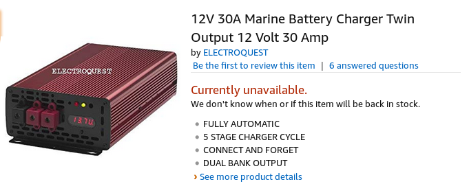

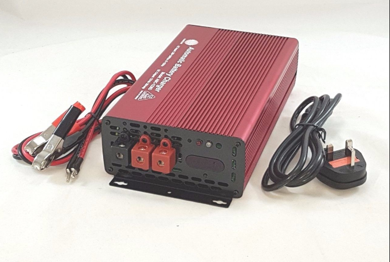

Those are not good chargers, best to dump and fit a smart charger and run everything of the batteries, including a inverter if required.
Newmax do one which has duel outputs, one outpoot for hab batts and second for strter bat.

The problem with them is they are not smart battery chargers and do more harm than good, they only float charge at around 13.4/7v, batteries require a 14.4v full charge and pulse to desufate the plates.
