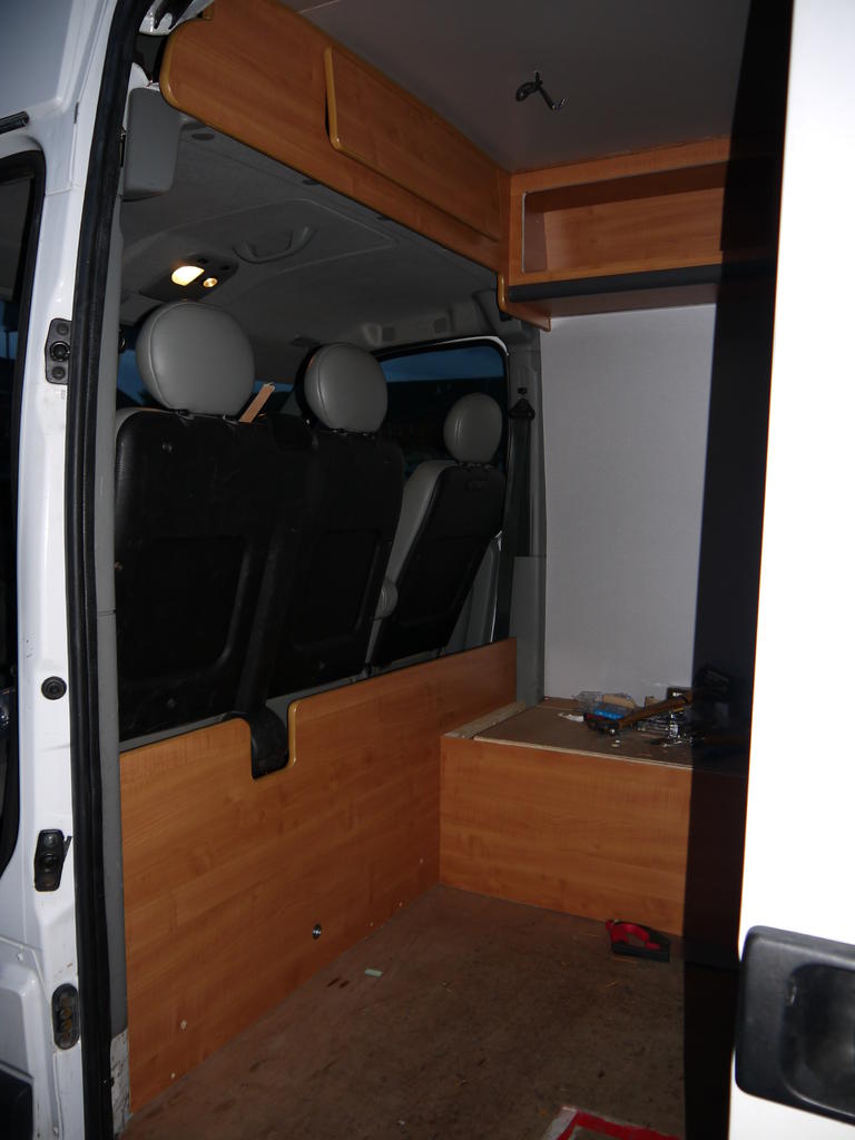

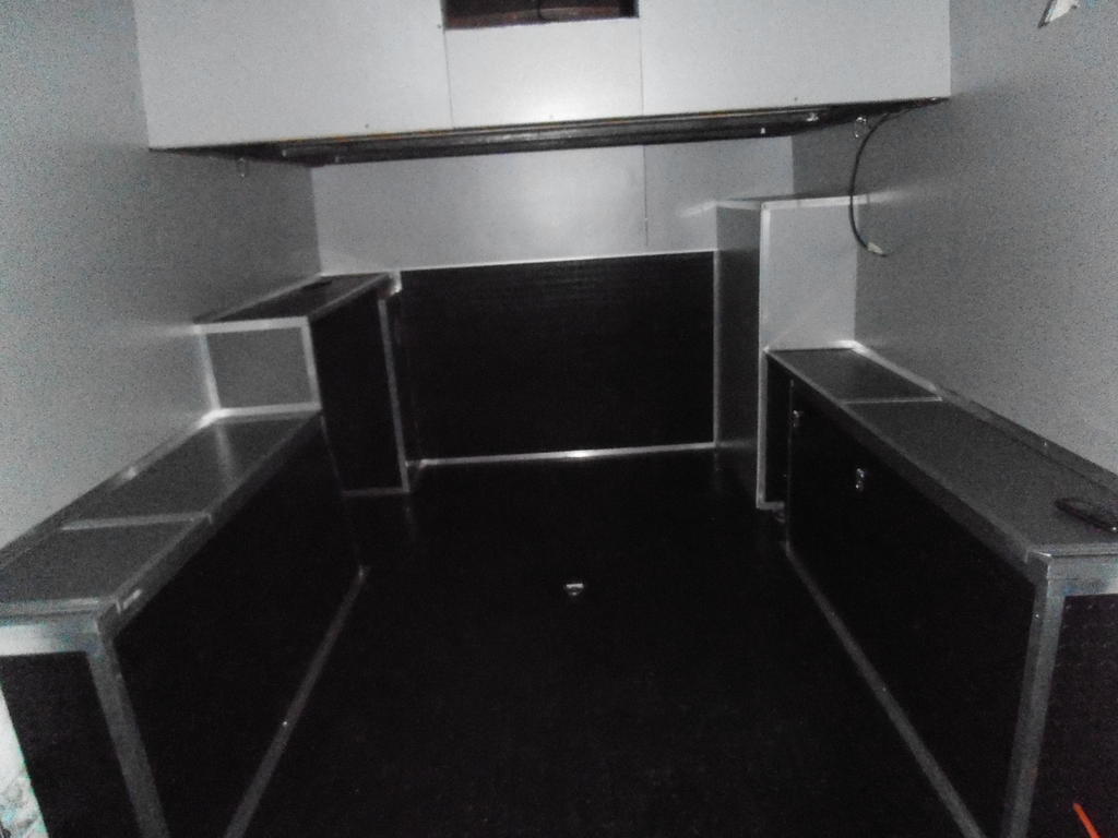

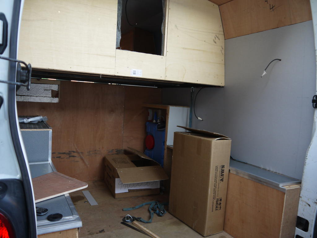

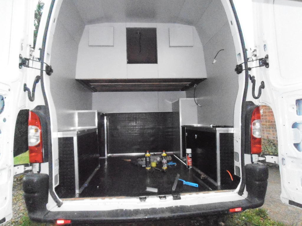

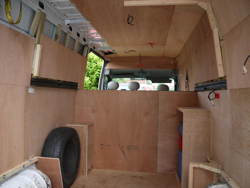

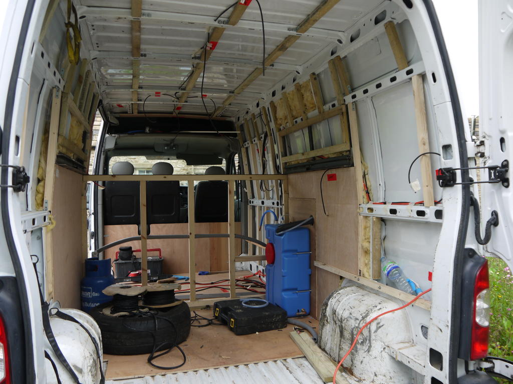

Some pic's of my Movano, nearly finished after 1 year.
some more pics

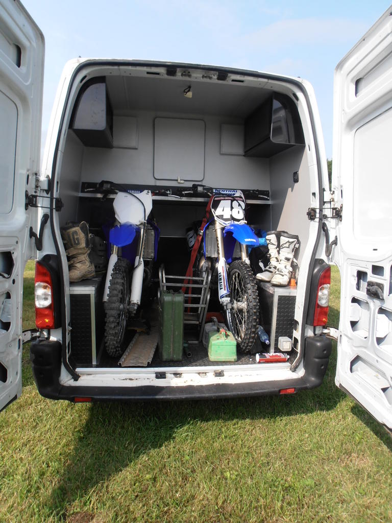

Thanks for the compliments, I always wanted one. I use it for Motocross, 2 bikes fit in the back with ease. I camped in it last September was spot on, I'm wanting to go just camping as well next year, I'm hooked.
I will have to get it registered with DVLA cause the MOT is due shortley as it is class 7 at the moment.
99% done
All that's left to do is the lighting in the garage. At Last !

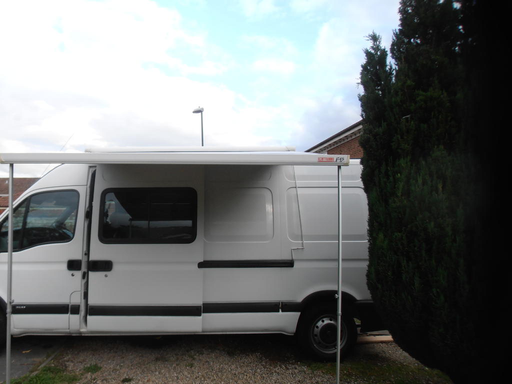

A really impressive, good looking, practical, professional job. I assume you have an awning or similar?

Thanks,
I realy enjoyed doing it, there are a few firms converting them as sport homes, race vans etc, very exspensive, but as with any conversion there is a lot of work, I wouldn't have believed just how long it takes.
A lot of the conversion was based on scribbled drawings I did, then a lot in the minds eye. I visited caravan dealers to get some ideas, learn a lot just from looking.
I would love to do it for a living, I would start another, beets crawling around on roofs !

self build
hello big tree, cannot understand why you blocked off access between cab and rear if that's what you did?......surely ventilation and access will suffer?.......pughed2
Very neat and tidy installation there you obviously have the flair and patience to make the finished camper look like a professional conversion well done all credit to you
regards Mike
Good question !
The reason for seperating the living area is because the bikes can get verry muddy & there is quite a bit of gear to get in the back as well riding gear, oils, petrol etc, just like a masive boot realy, plus I can stand up in the back to get changed, there is a door between the garage part and the bunk so you can put your clean clothes through onto the bunk when you get changed, it keeps the muck out of the front.
When it is hot I just opened the rear hatch & the side door and you get through ventilation.
The extra height in the back makes putting bikes in easy, no crawling around or dropping the handlebars to get them in. I insulated the roof, ceiling with celotex board insulation & it works keeping it cool inside in the summer. I was going to make a shower in the back wirh sort of demountable base, not hard to do but it meant a water heater etc.
I had thought of making it all open so the bikes could go in if wanted but leaving more living room for camping. After years of putting them in my work van with amount of muck, dust & smells that rae made I decided to close it of.
It works spot on even with the smaller kitchen living area as aresult of the garage.
I wish I had done one of these years ago my Son & I went to Peebles in Scotland this year he went mountain biking, we went to Edinburgh for the day, we parked up near the parliment buildings I made a cupa in the back sat & opened the side door , I said its like opening your curatains at home but with a different view every day,
