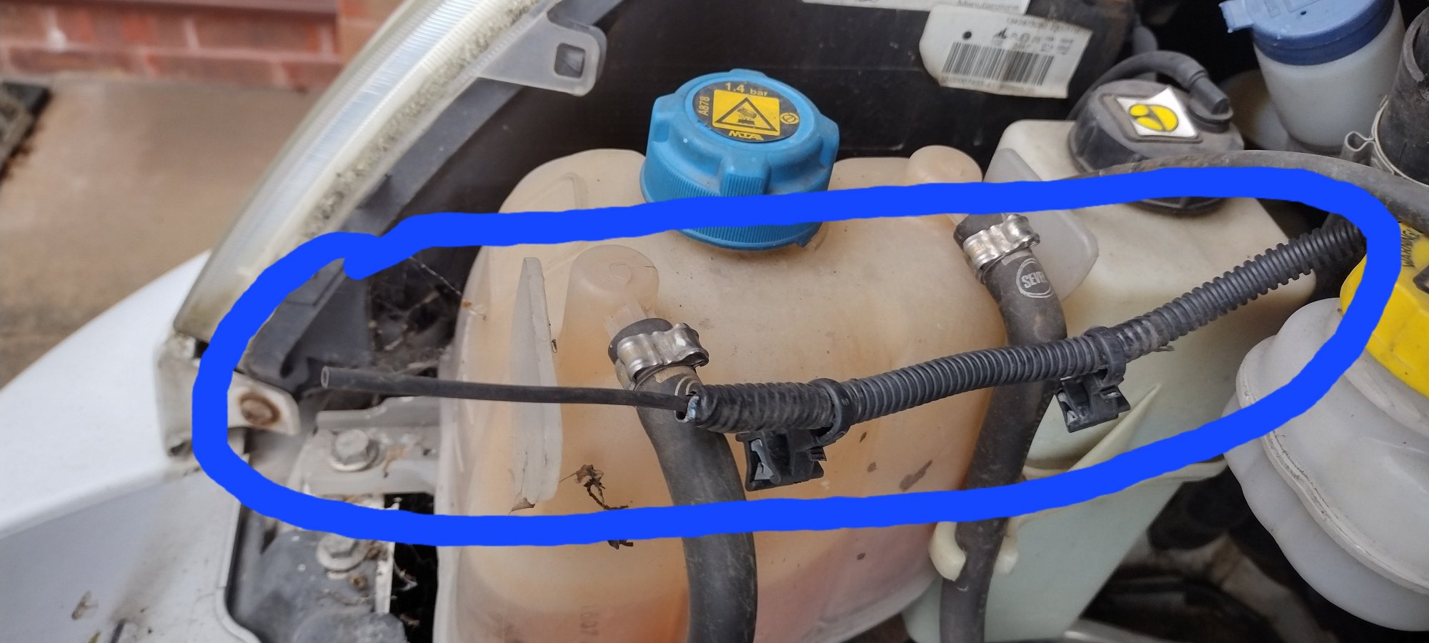

Been away for 3 months (New Zealand & Australia) and the campervan (2009 Fiat Ducato Adria Twin) is all OK. Apart from the windscreen washer pump, which has stopped working. New one ordered and is on its way.
In removing the pump I noticed this 'pipe' - it's got an open end, hanging down by the washer bottle. It has clips so looks like it should be secured to something. Just wondered what it is and whether it should be connected to something.

Can you follow the pipe back and see what is on the other end?
Only suggestion at the moment is a drain pipe for the scuttle. These usually go straight down form the scuttle and discharge near the tyre.

The drain for the scuttle is much bigger. Did trace the 'pipe' back but it enters a loom with other pipes / cables so difficult to find the origin.
Looks like a vacuum pipe if it was a petrol engine, possibly part of the windscreen washer setup ....... 🤔🤔
Looks like it's got the remains of broken clips on the protective conduit ....
Maybe see IF you can see the other bits of the clips to give you a clue where it originated .
Just put a bike pump on it and look for the hiss. Its a bit long and heat / mark protected ? But them clips look like it's made for ?...
It looks like a vacuum pipe, has the EGR valve been blanked off?
EGR valves have a vacuum tube to control it
Is that not the pipe to the washer spray nozzle which may be connected to the bonnet with the square stickit blocks ?
Try working your washer and see if the water comes out may also solve the problem of the washer motor not working!
My first thought was a washer pipe but that doesn't explain why it has protective conduit on it, it suggests to me that it is routed to somewhere hot which is why I asked about the EGR valve
Thanks to all the Ducato detectives for your contributions to solving this mystery. Most likely answer is it is the EGR vacuum tube.

EGR valve was replaced in September 2022, so possibly the vacuum pipe was not clipped back on

See above. There is power to the pump and after removing pump I connected a 12v supply to the pump and it did not run. So it looks like the pump is dead, replacement arriving tomorrow.
