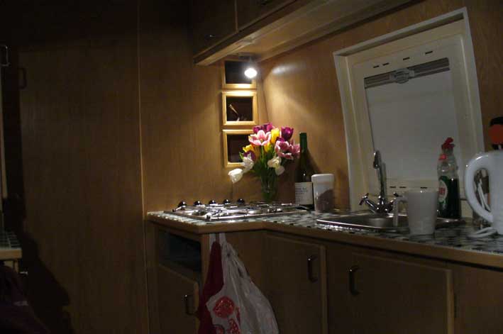

I bought a rather travel worn 2008 Renault Master and then set about converting it using a very lightweight construction method which has left me with a very healthy load margin of somewhat over 750 kgs.
My design for the interior was dictated by the fact that I wanted a large useable shower/loo and a large amount of day-time floor space so that my 3 Springers had enough room to be comfortable, then at night the bed slides out sideways to form a full size 6' x 4' 6"

Hello Mark;
The lightweight construction method I utilised was really rather a basic idea of not to use any supposedly lightweight and quite thick finished plywoods from the likes of Morland.
After having the van professionally spray foamed, I then lined the walls with 4mm ply and then constructed a full framework out of 25 x 50 mm tanalised roofing laths to which I then attached 4mm oak ply and for the edges I attached 15mm formed right angle beading and when all sanded down I then coated it all with 3 good coats of satin varnish. In places where I wanted more strength I glued sections of 25mm Kingspan to the reverse side.

No I hadn't built one before but as a former owner of 2 special camping a la fermes in France I had seen a lot of professional conversions, most of which were dire and one or two self builds which had far more thought given to userbility.
With these thoughts in mind and knowing that my build would have to offer loads of user friendly space so that my 3 Springer Spaniels had enough room as well, I then set about planning the layout.
From the outset, my plans were all drawn up on the computer with either a LWB or XLWB Sevel built van (Fiat/Citroen/Peugeot) in mind as they offer the widest and squarest load-bay area................ It was only at the very last moment that I changed over to the Renault Master despite the load-bay being nowhere near as user friendly as I believed they should normally be far more reliable.
Over a year now in regular use wouldn't change a single aspect of the design, even now when 'Millie' is being used as a full time dormitory whilst we are in the process of rebuilding our recently aquired house.
