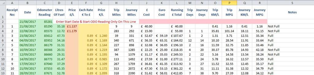

I created a spreadsheet to calculate my MPG & other figures whilst on a journey in the motorhome.
I have (hopefully) attached a screenshot below as a sample & included the Excel file for anybody who may find it useful to use.
It is locked to prevent the accidental deletion of the formulae, but can be unlocked with the password "WildCamping" to enable full modification to your own requirements.
If you spot any errors in the calculations please let me know & I will correct & re-post.
JourneyInNumbersSample.jpgView attachment JourneyInNumbers.zip
View attachment 60105View attachment 60104

Thank you for the comments.
I did this from scratch as a learning & refresher process in using Excel more than to calculate my MPG; there will be plenty of others who have done that before me & better.
By not searching for what had gone before I hope to have added something different though, & maybe the currency calculator part is that difference.
To produce a more accurate MPG figure I believe the sat-nav mileage should be used as opposed to the vehicles odometer & I began experimenting with that on the second sheet.
Unfortunately I have a tendency to require variety in my leisure & I'm already on to my next challenge so it may be a while before I return to it.
1) In the spreadsheet there is an underling assumption that the vehicle is filled to exactly the same level every time.
If I'm paying motorway prices I only put enough in to get me to somewhere that is a little cheaper.
When I monitored my mpg by spreadsheet I had a column for "extra litres to fill up to top". This was only an estimate but gave far more accurate results.
2) In columns Q & R you have calculated the average journey MPL / MPG by averaging the individual fill up MPL/MPGs.
This is only valid if each of the fill ups is for a trip of equal length.
You should be calculating a weighted average by totaling milage and fuel and calculating consumption from these.
e.g.
Trip 1 100 miles; 9 litre (2 gal); mpg = 50
Trip 2 300 miles ; 45 lite (10 gal) mpg = 30
average mpg (using your method)= 40
True average mpg (400 mile /; 12 gal) = 33.3
3) Tidy up the formulae
a)The SUM function is superfluous in rows H-R.
b) You could take out a lot the ISBLANKs by changing the option for displaying zero values
c) Where you have only 1 price add them together (the 2nd one is zero)
e.g the formula in J3 could be "=D3 * (G3+E3)". a lot simpler than your version.
On a small spreadsheet this doesn't really matter, but on large sheets the performance improvement can be impressive.
Please don't be offended, in a previous existence I lectured on spreadsheet design and audited other peoples work.
One thing I always told them was that letting someone else check their work was never a waste of time and that listening and heeding always improved their own skills.
(I still get requests from ex-colleagues which are paid for in beer when we meet up. )
e.g.
I recently had a dispute with Santander which went to the Financial Ombudsman.
Santander made an offer supported by a spreadsheet and the Ombudsman recommended tht I accept it.
I pointed out three errors in the spreadsheet and Santander revised their offer to 3 times the original one.
To the non mathematicians ... Yes I do have a life !

Thank you for your analysis & the extra education.
I have no training in Excel & only know how to use it through searching the internet to find solutions to the needs I have. It is useful to have an expert look over my amateur efforts & comment.
Far from being offended, I am pleased to receive the constructive advice.
With reference to your particular comments:
1) Personal preference I would suggest on this one as I choose to ignore any KM/L or MPG figures based on the tank not being filled up as even estimating the extra required would only lead to an estimated figure for MPG. Maybe I should set a flag column to blank the figures if the tank is not filled.
2) {Good spot. KM/L should actually be M/L as I did not convert to KM, only to litres. This is the type of genuine error I need to correct. Column O is actually showing miles per litre, not kilometers per litre as per its heading.}
Correction Edit. Column O is correctly calculating KM/L. I guess reference to MPL was typo by r4dent.
With regard the actual average anything less than a complete tank fill can only be an estimate as you know.
Although my sheet calculates the trip average, if the tank is not filled on successive fueling stop it is a superfluous calculation. My hope was that the 'journey MPG', when followed by a note showing the tank was filled, would be accurate.
My sample appears to bear that out as the figures are very close on each calculation when accompanied with a 'Full' note.
I will attempt to modify my calculation, using your calculation method, to make it more relevant during the "Not Full" fillings.
3)
a) I did not know that. I thought I always had to use SUM function for calculations. I will investigate further to learn when it is & is not required.
b) This is one I need to learn more about. I used ISBLANK as I don't like the zero's appearing before a row had been used. I will seek out the alternative you suggested. I could not fathom how to stop the £, € & - symbols appearing in columns J & K even after using ISBLANK.
C) That is much tidier but it does not work with the exchange rate calculation. I will see if I can use the example offered to include the exchange rate too.
Again, thank you for taking the time to analyse my efforts & the constructive advice offered.
