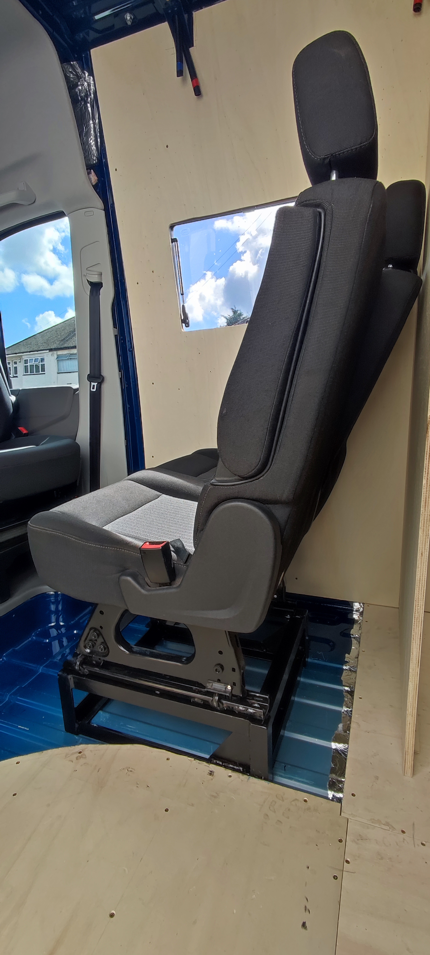

I have done something very similar to what you want. I did not move the double seat as i did not have one, but the disadvantage in doing that is that you do not have the seatbelt anchor point on the pillar. I used a double transit minibus seats which i bought from the bay. I also went to a specialist company to fit them. They have produced a frame so that the back seats are at the same level. Apparently, there is no standard to apply to such a change, only guidelines: the seats or the frame has to be bolted to the floor using a spreader plate underneath which is at least 10cm X 10cm.

I have done something very similar to what you want. I did not move the double seat as i did not have one, but the disadvantage in doing that is that you do not have the seatbelt anchor point on the pillar. I used a double transit minibus seats which i bought from the bay. I also went to a specialist company to fit them. They have produced a frame so that the back seats are at the same level. Apparently, there is no standard to apply to such a change, only guidelines: the seats or the frame has to be bolted to the floor using a spreader plate underneath which is at least 10cm X 10cm.View attachment 205469

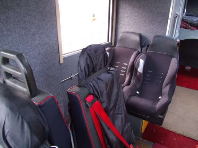

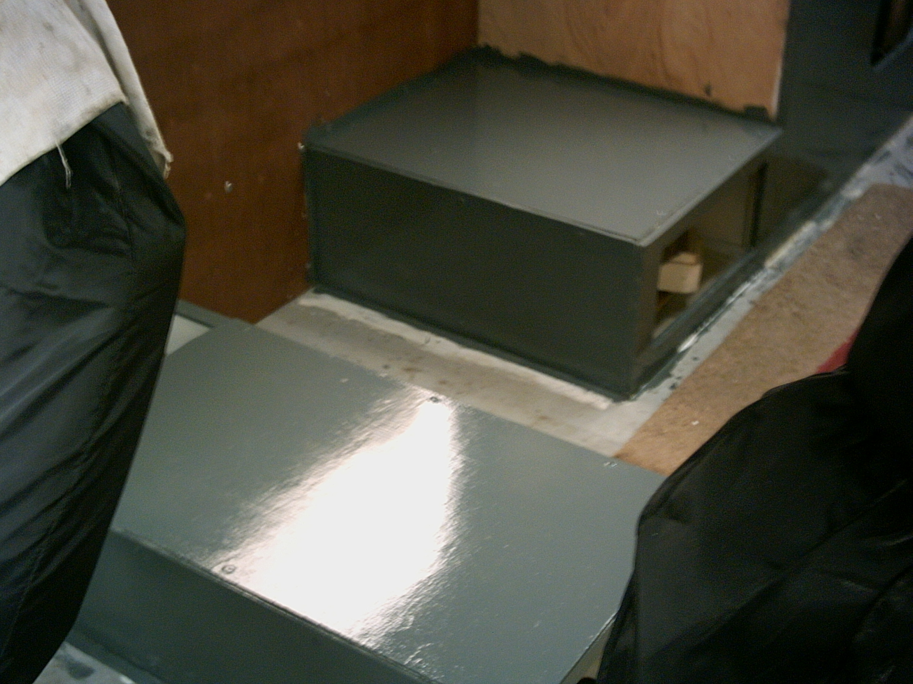

If the seats are from a bus or other with fitted belts then all required is the spreader plates under the floor bolted down with high tensile bolts nuts and washers, I built boxes and mounted seats on them, six seats in all, and front 4 swing around and lock, handy to watch TV on the bog wall.van h.jpgtable seats.jpgkearny b.jpgkearny a.jpg
