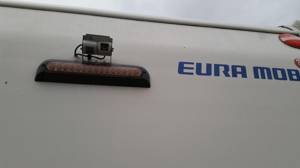

I also have been having problems with my reversing/rear cameras. I was able to swop a faulty one with a camera I had spare in the garage. I also had bought a single camera from ebay previously, to fit by my rear number plate on the side where my grey waste outlet is located.
It took an afternoons work, but I now have an extra camera at the rear close to the ground so I can line up the waste outlet with a sewer drain (at home)
