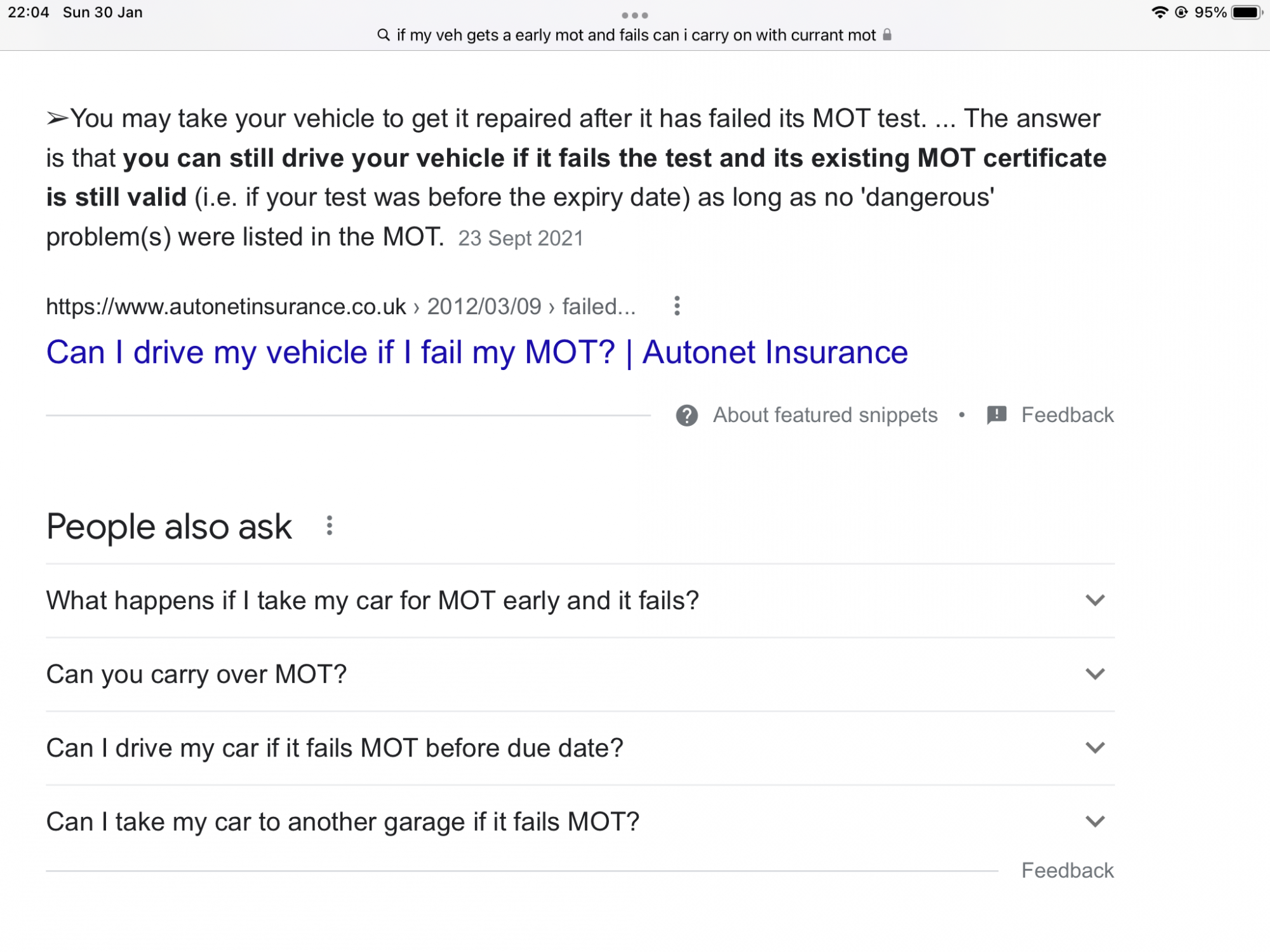

Right my vans due it’s mot In march but I want to get it in a few weeks earlier say middle of February. If it fails Mot is it unroadworthy and have no mot from that day or dose the date on the original mot still stand i don’t think it would fail but it’s a question that sticks in my head.

The date on the original mot still stands but of course if the van is stopped and the fault is found it will be unroadworthy.

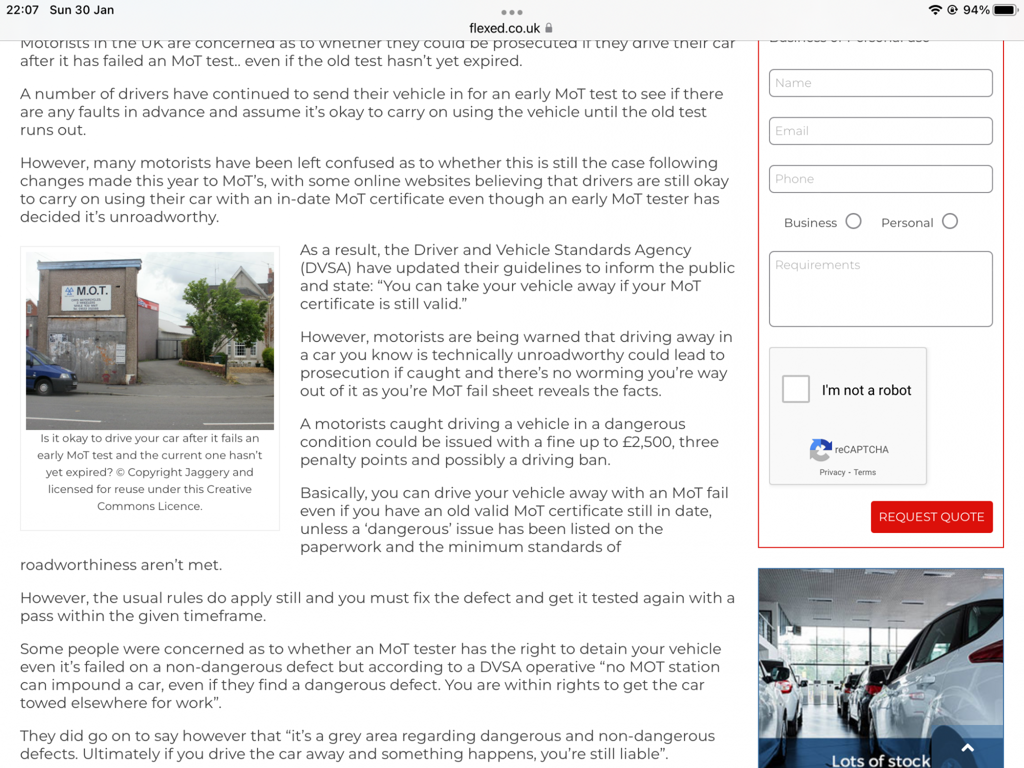

Same in England. If the fail is considered dangerous you are not allowed to drive it away even though the old MOT is still valid.
If there is an MOT fail, then the original MOT Expiry date still stands and the vehicle can be used perfectly legally between failing the New MOT and the expiry dat of the Old MOT.
The concept of MOT = Roadworthiness is logical but not correct. A vehicle can be unroadworthy but pass an MOT and vice-versa. Strange but true.
A vehicle CAN also be driven away If if has a Dangerous defect. The idea that you will be prevented from doing so is not correct. Whether it is a good idea is again another matter.

You can take your vehicle away if:
• your current MOT certificate is still valid
• no 'dangerous' problems were listed in the
MOT
I read that as you need to comply with both, it is not an either or.
