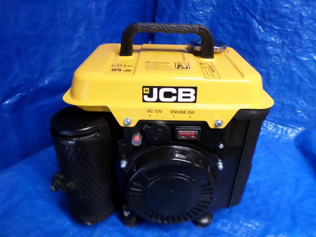

Then all you require is one of the litle 2 strokes giving about 750/850w which will run 4 hrs on 4 ltrs fuel,cost is from about £75 to £90 depending on where you buy,i bought a large amount for £50 each and sold on for £70 if i can remember correct.
Mine has a 12v output but its better to plug into 230v outlet then into van plug which will power you charger which in turn should top up both starter and service battery,if not use a charge splitter or relay to join up with a switch on dash.
As far as the house you can get a a/b switch which connects between meter and fuse box ,cost about £40 ,so mains goes on a and geny goes to b post.
House heating pump uses about 40w so a small geny as iv shown wil do that and led bulbs tv etc but a fridge will burn easy 600w and more on start up so you will be on limit with this geny.
If using a electric cooker then a 2500/2800 petrol or derv geny will be required to run hot plates etc but not a full blown oven.
