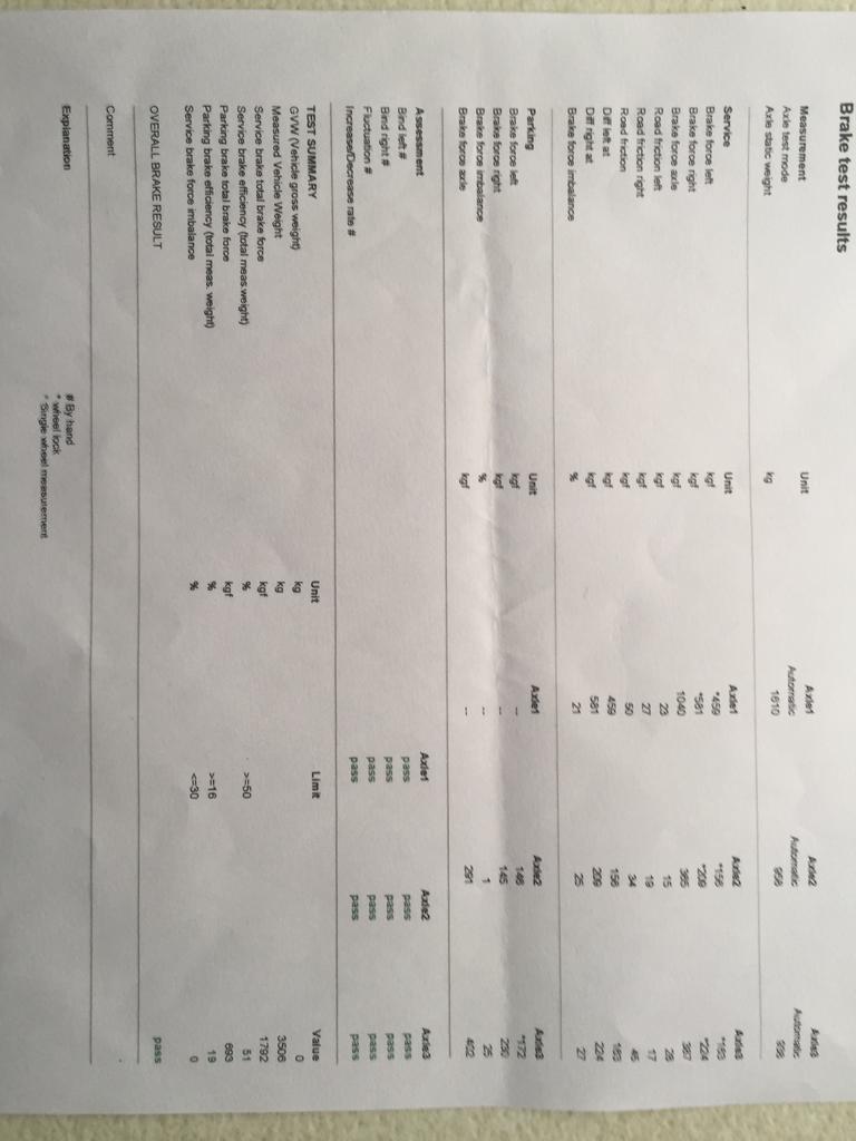

The MOT on The Nest (my Tag Axel 4500kg Peugeot Boxer Livaboard Home) took 55mins, all of which was done in full view of the waiting rooms MASSIVE viewing window. They even Weigh individual Axel weights & give Print out.

Sounds good NZ. Just for info, if you had been overloaded on an axle would it affect pass/fail?
Hi ya Nabsim,
To be honest I don’t know !,, maybe just a Heads up or even an advisory maybe!!. I regularly take mine to a weight bridge anyway so not a surprise regarding the actual weights, just surprised they gave me a Print out of it attached to my MOT. I think that’s Brilliant & Good Practice.

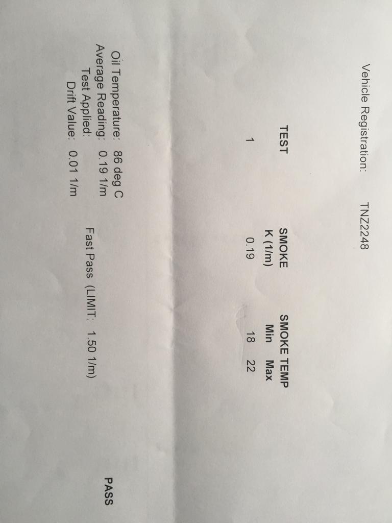

Here is a pic of the ‘Gumph’ that they tested as ‘Part’ of the MOT, & if you look it’s got the Axel weights among it all.
THEN they done the OIL Temperature & Smoke emmisions & a load of other stuff I don’t understand
