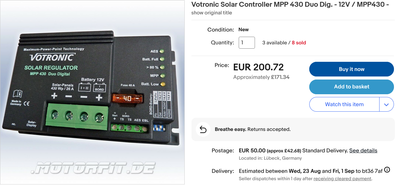

Votronic do a duo with 1 amp to starter battery, the rest gors to the les batts, mine has been working for years now, no bother.

Votronic do a duo with 1 amp to starter battery, the rest gors to the les batts, mine has been working for years now, no bother.View attachment 122531
I searched for the exact description Trev and it doesn't exist on ebay.
A search for Votronic brought up loads, but not that one so you really do need to stop going on about stuff if you can't provide a clickable link, surely if Linux is so good it should be as easy as it is in Windows.
If you can only provide a screenshot then can you include the current item number too.

All out of stock ex the 430 which is the big one, and its nout to do with linux.

If its the one on your page victron then its only a pmw which is old hat, its a MPPT you want.
