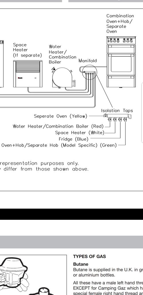

Is this any help....
From the owners manual...
