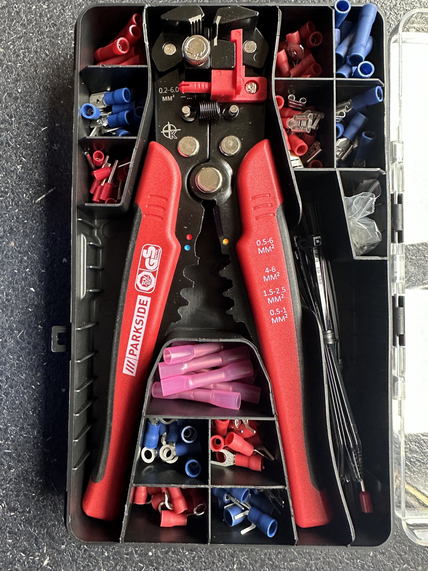

Picked this up in Lidl this morning a real bargain at £6.99.
That one is just for bootlace terminals Trev, not commonly used in Autos but handy enough when wiring through a chocolate block (better than bare wires).

Its worth every penny.. a nice crimp set there

It is certainly possible to get better kit than LIDL, but it usually involves spending quite a bit extra money.
It is very easy to get worse kit than LIDL at the same price or more.
Those Wire Strippers alone in the original post are usually bought for many pounds more from places like eBay and Amazon, even ignoring the case and the connectors bundled in. They look identical to about 4 pairs of wire cutters I have - and paid more than £6.99 for each of them (I keep them all and cannabilise them as different parts break or wear out).
