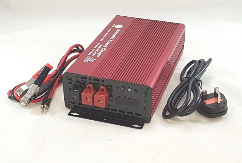

M home so called chargers dont realy charge the4 battery, they just supply around 13.5 volts which in turn keep the lights working, these so called chargers wreck batteries, best to refit with a smart charger with min 10ah output, if living of gride and 2 battery bank then a 20ah or larger would be best.
Or a duel 30ah which will have a seperate output to starter battery.
