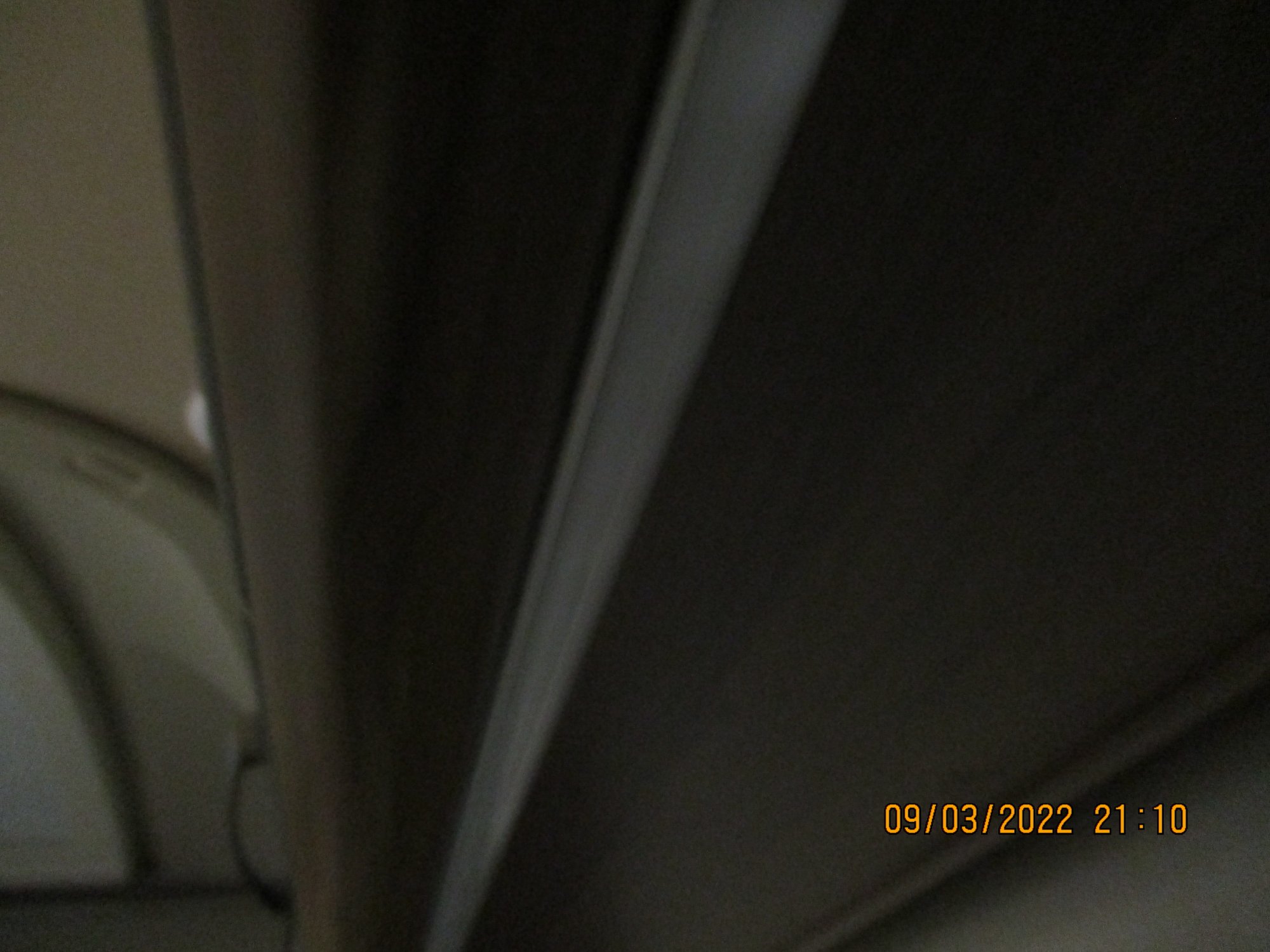

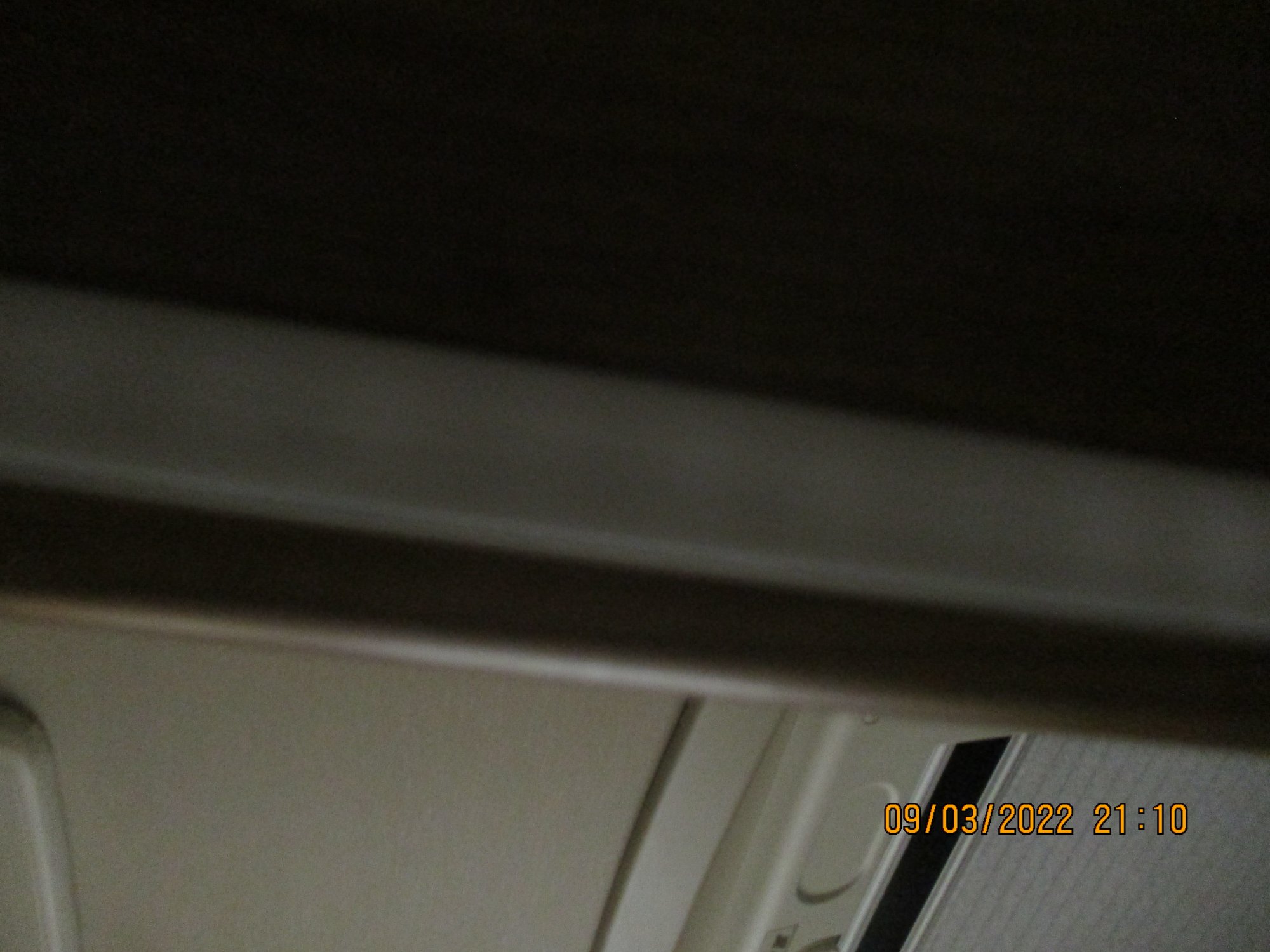

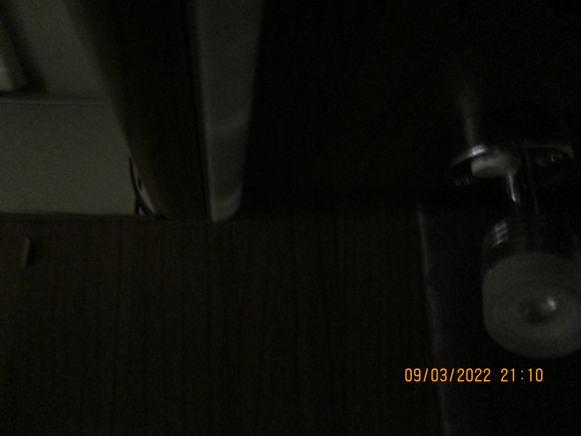

One of the lighting strips in our MH has developed an intermittent fault. It won't go on for weeks/months when it should be; and then, miraculously, when it decides to light up does so at a random time only to then go off a few days later. When I say random, I mean that the lights are on in the MH and it isn't working but then an hour or so later for example it will just decide to light up.
My first thought is that it may be a loose connection. Therefore I have attached some (really bad) photos of the strip in situ as my question is: how do I get the cover off it to have a look at the LED strip itself?
I don't want to force it nor do I want to pull the whole thing off where its stuck on.
Any ideas? I am assuming that it is a 2 part item with a base and lid/diffuser, which is the part I'd like to get off without wrecking it.
Sorry about the photos as I took them at night. I can do clearer ones in daylight if it helps but hopefully you get the idea. Its the white strip in each of the photos I'm trying to sort out.

This looks like the type of light which utilises T5 fittings, with a male and female on either side for interlinking. if so the cover is not designed to be removed, and the light is held on by clips, which are screwed on to the surface then the light is simply pushed into place. If this is the case, then remove the light from the clips, and then unplug from cable and do a voltage check from the female T5 supply. If the light is connected at both ends this means it’s interlinked to other lights. If they are working fine then it would suggest a fault suggest an internal fault within the light. If it’s only connected at one end then the fault could be in the supply side or as above, a faulty light.

No it isn't that one I'm afraid. It has a triangular cross section and there are no clips: it is flush to the underpanel and neatly hidden behind the lower edge of the cupboards above (which have a slight lip or flange to them at their lower edge)

I cant get to/see either end to check the connections at present. I'm hoping that if I can get the diffuser off, it will...er...throw some light on things (sorry).
