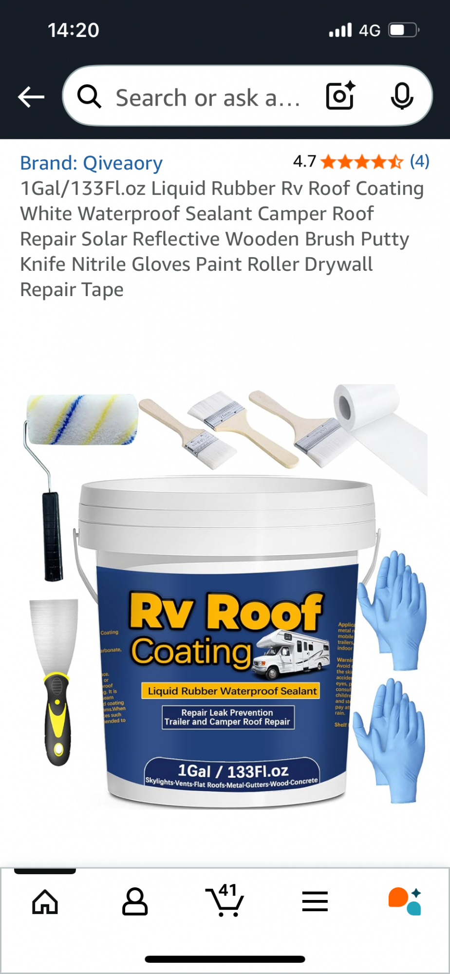

Prep & seal all the joints on the Entire roof & Paint it 🤷🏻‍♂️.

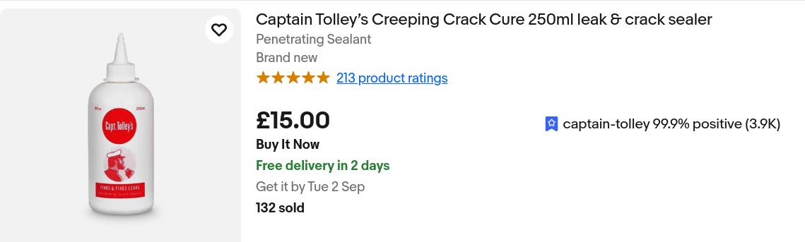

Tery captan tulleys leak sealer, its thin and finds tiny leaks easy.
