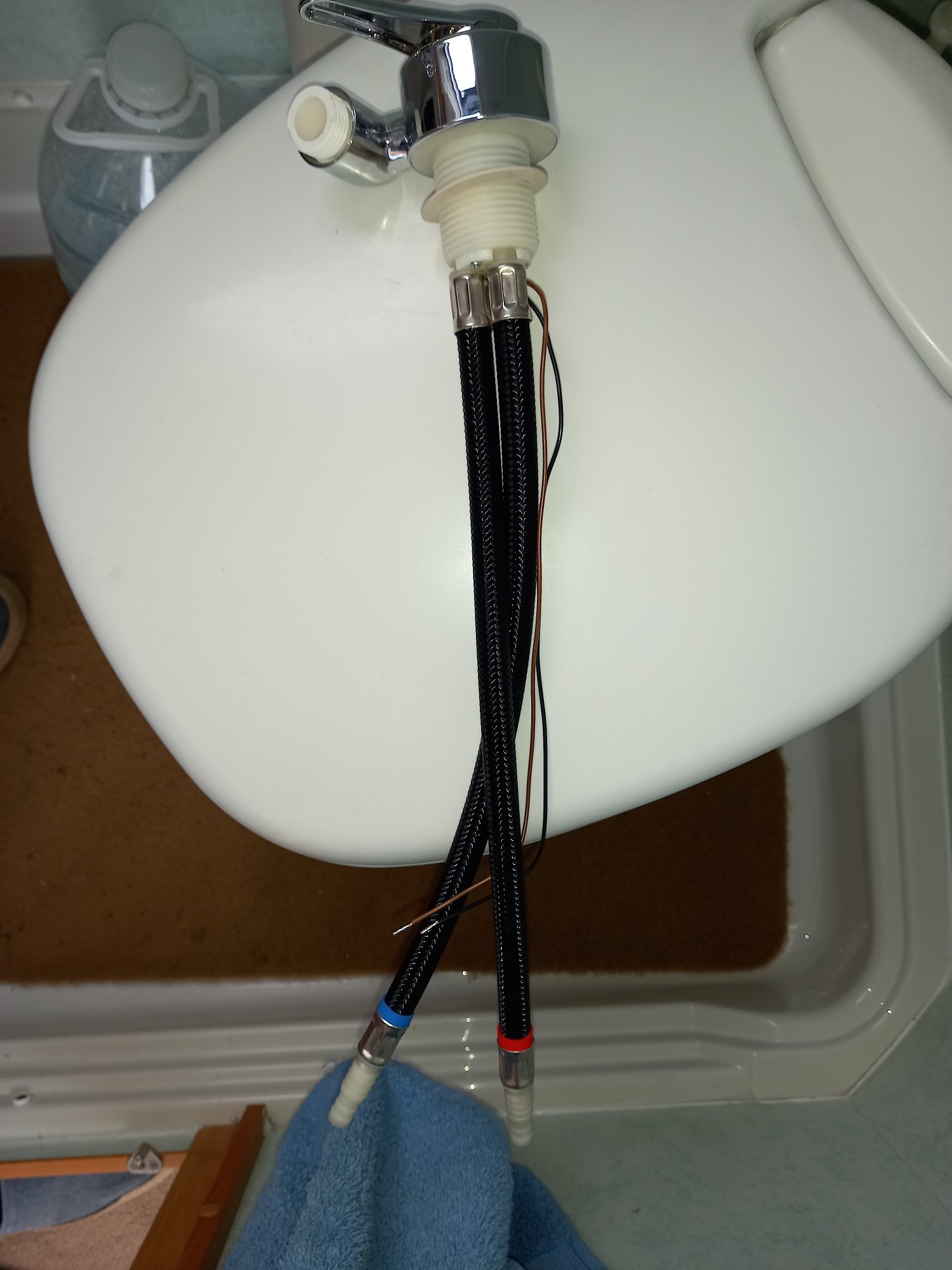

The plastic bit which the hot and cold water hose goes into is cracked or broken and I can't find the bit I need to buy unless I have to buy the whole fixing and tap for 70 odd quid I assume.
We can't use the water in sink or the pump in motorhome as the water just flood out the shower fitting under the basin.
Any pointers? Would be much appreciated.

Without actually seeing this it’s difficult to say, but it sounds like the plastic has went brittle with age, and you need a new shower mixer. Make sure you buy a mixer with the correct pipe fittings, motorhomes are normally 10 or 12mm.

Bought a comet shower mixer tap but I think it's the one with a micro switch which my motorhome didn't have. The pictures below show existing fittings and the new tap. I can't see how I can replace the hot and cold pipes but it might be I can't as I need a non micro switch tap which I haven't been able to find online. Any guidance really appreciated as taking motorhome in to dealer's Monday to get it valued as part exchanging it but don't want to take it without new tap if possible... but they might take a bit off to fix the tap themselves????

the one in my leaking shower tap thread is a microswitch one, but the wires just hang loose, I was just about to cut them short but then saw they may impede the retractable hose so left them alone.
