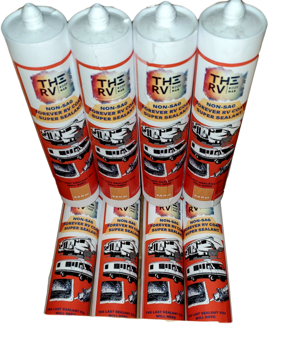

So it's been 11 years since I fully converted my Transporter high roof van. At the time I fitted a fiamma roof vent and sealed it with a none setting mastic like stuff but after 10 years it started leaking were the sealant was weathered and cracked. About a year ago I got a new vent the same one as before and this time I used Sikaflex but this has already started leaking. On doing some research into sealant one stood out called forevercoat self leveling sealant but it's a brand from across the pond in America and I can't seem to find it over here. Does anyone know of any equivalent brand sold over here in the UK.
