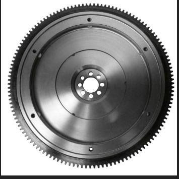

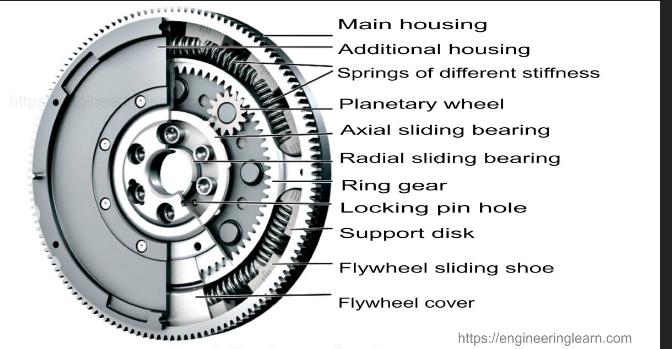

Type a is conetic new type, b is old type units

Basicly new type is a cushened unit bit like a elastic band where as the old solid unit was a bit more harsh, well if you are a cr-p driver.
There are some solid replacements on the market to swap back, but beware merks have a habit of bu--ering up the back crank bearing housing im told.
Would i like new unit, big no as just more to go wrong.
