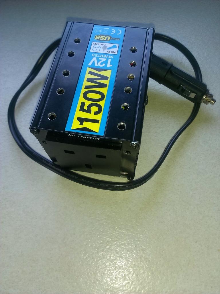

I Haven't got a cig Charger for it, I use an 150w inverter via my Cig lighter to Charge whatever rechargeable bits n bobs I have while I'm running my Engine Or Traveling, THEN if needed I use my Power Pack to Top it up if I'm staying put for a second night.
Now I HAVE drilled some extra ventilation holes in my small inverter to aid air flow cooling. But this all works for me.

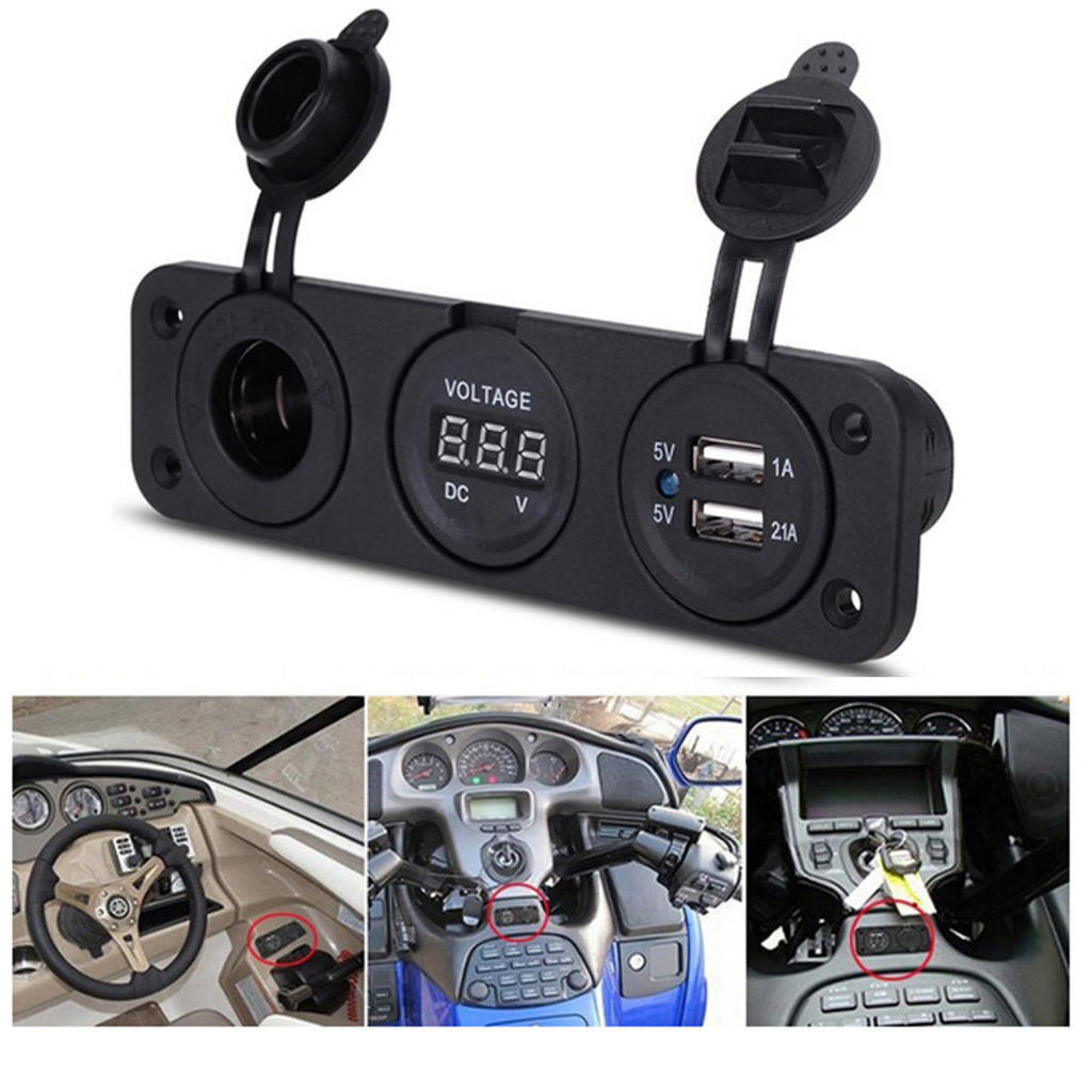

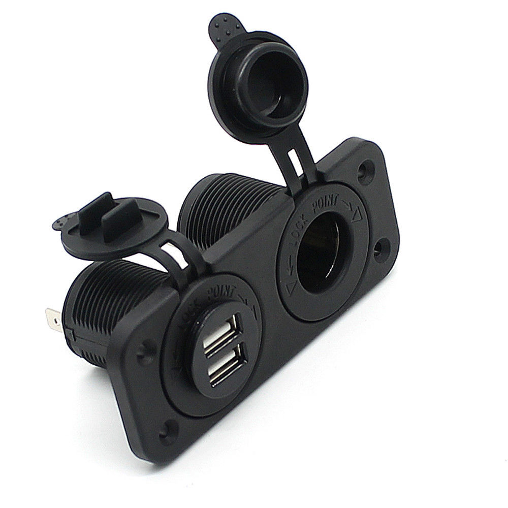

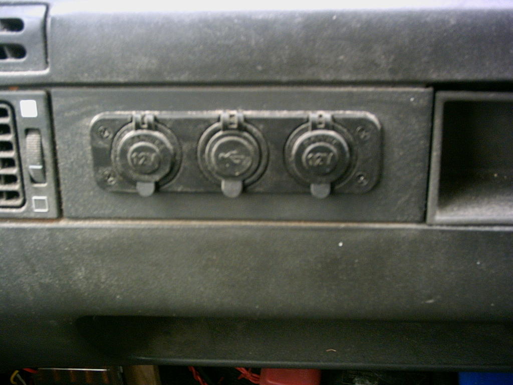

I use the heavy duty cigy/usb sockets and thick wiring ,these usb combos can be bought of ebay.
Best will in the world chap .....theyre NOT that heavy duty ....soft plastic melts soon as it gets even slightly warm ....the Bakelite DIN type are far better at dealing with anything like sensible draw OR go the anderson socket type .
