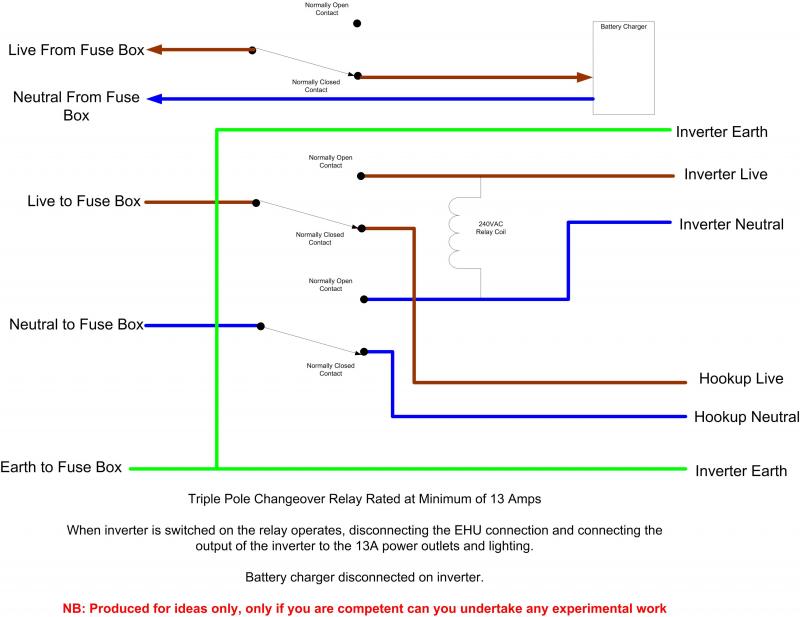

I've modified the power cabling so that the inverter can supply all the sockets with auto changeover from hookup, goes through the fuse box so all are protected.
I've uploaded diagram of what I've done
