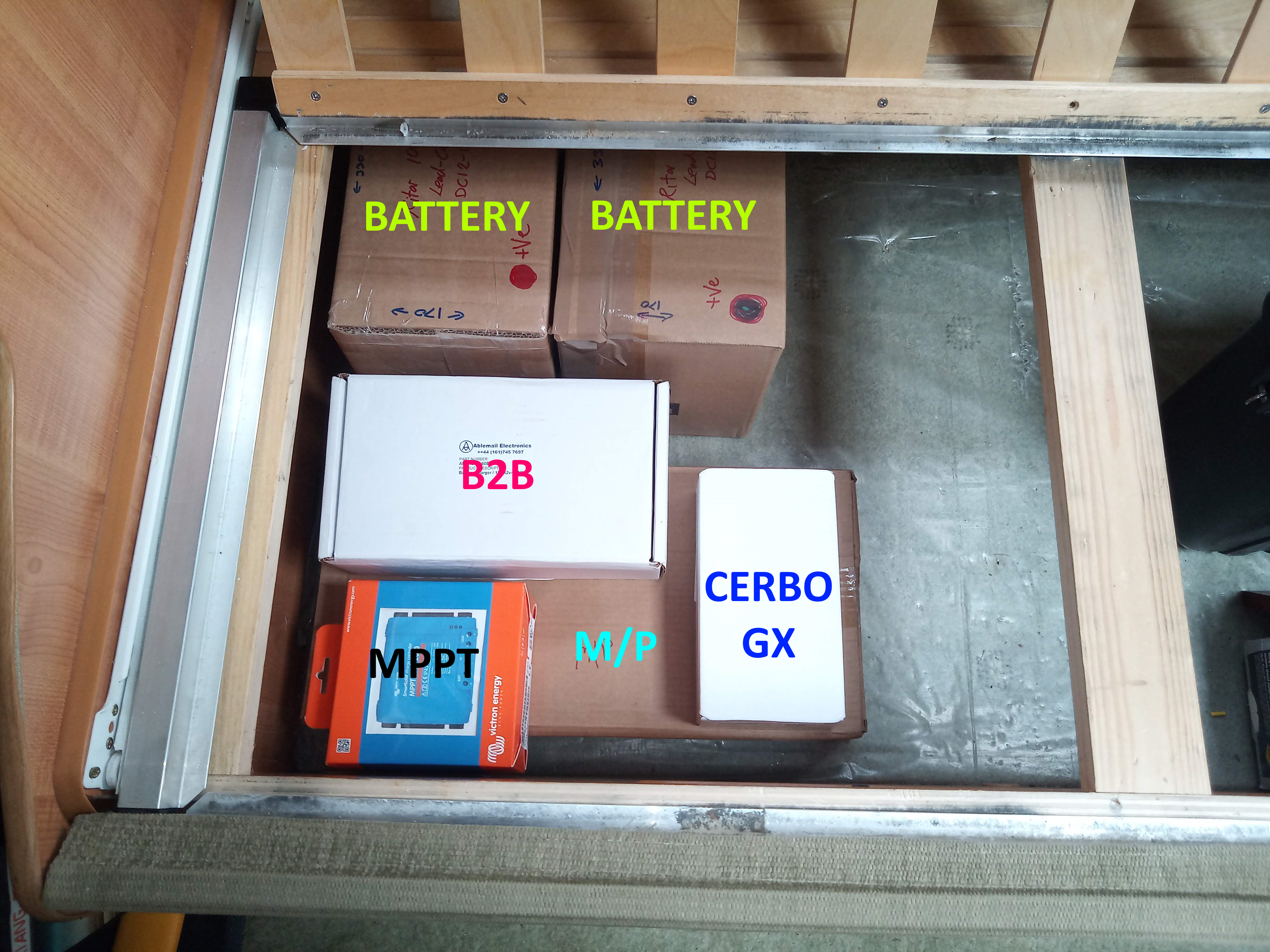

I made mockups of the batteries (a lot easier than lugging actual batteries around!), along with boxes representing the other components being fitted (B2B, Solar, Multiplus and Victron Cerbo) and laid them out in the space I am considering using internally ...
The other bits of kit take up more room than the batteries!
There would be a removable shelf to sit above the Multiplus for the other devices to mount onto.
I think using the internal space as shown for the Batteries will make the best sense as it keeps everything together and that corner area is generally awkward to access for the kind of reasons given by Mistericeman (had to remove all the cushions, backs and lift the base up to access this as shown. There is a front hinged door but that doesn't allow easy access to the sides, just the middle).
As a side benefit, I can pretty well add this as an "auxiliary" setup and very easily incorporate into and also reinstate the original configuration, which could be handy.
