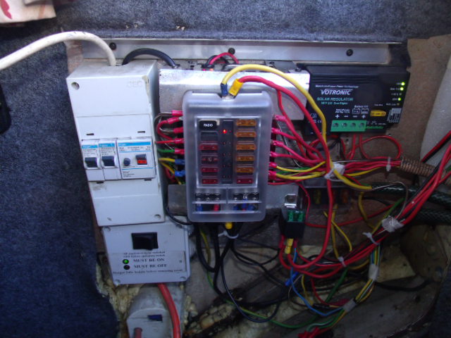

Better to bin these over complicated systems and go simple with all separate units.
