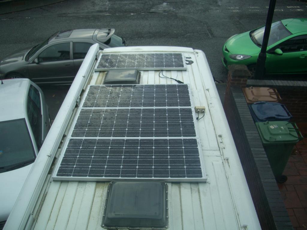

I used 24 self tapping bolts to fix my four 100watt panels to my roof with no probs used sikaflex as well .

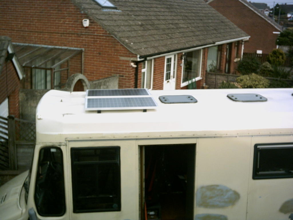

I used fence clamps and bolted through f/glass roof but used sealant when doing my build ,though you could do the same and fit blanker plugs to inside roof under bolts in case you require to remove the lot at some time down the line.
How clean is that roof, oh so good, only dirty people wash a roof that good,!!!!:banana:
