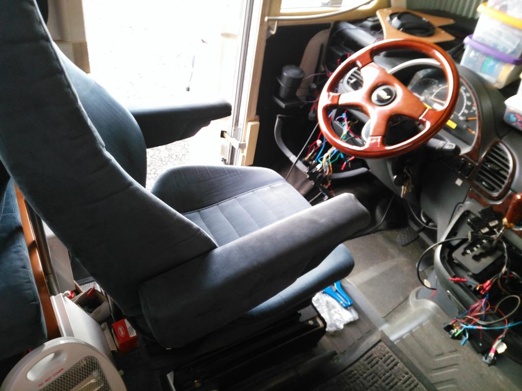

I'm working my way down my list of TTD to leave a 2 year SORN behind me and get into the sunshine for the winter months.
This week's major task is to sort out some issues with a pair of 2004 vintage ISRI 9100 rigid seats.
Firstly they look old and sad, the material is what I would describe as soft suede texture, dark blue moleskin.
The arm rests, and headrest fabric is shiney and grubby.
One arm rest has snapped off.
The seats are not suspension seats, they are rigid and on a swivel.
So I trawled the web looking at replacements but ISRI current models such as the 6500 air suspension truck seats are selling for around £750 each for a basic seat, once headrest and armrests are added, +VAT and shipping, I was looking at around £1800. That is in black fabric, I am not upsetting myself with trying to get a fabric matched pair of seats, Black is fine with me but almost 2 grand is not, a person can have a lot of fun with 2 grand !

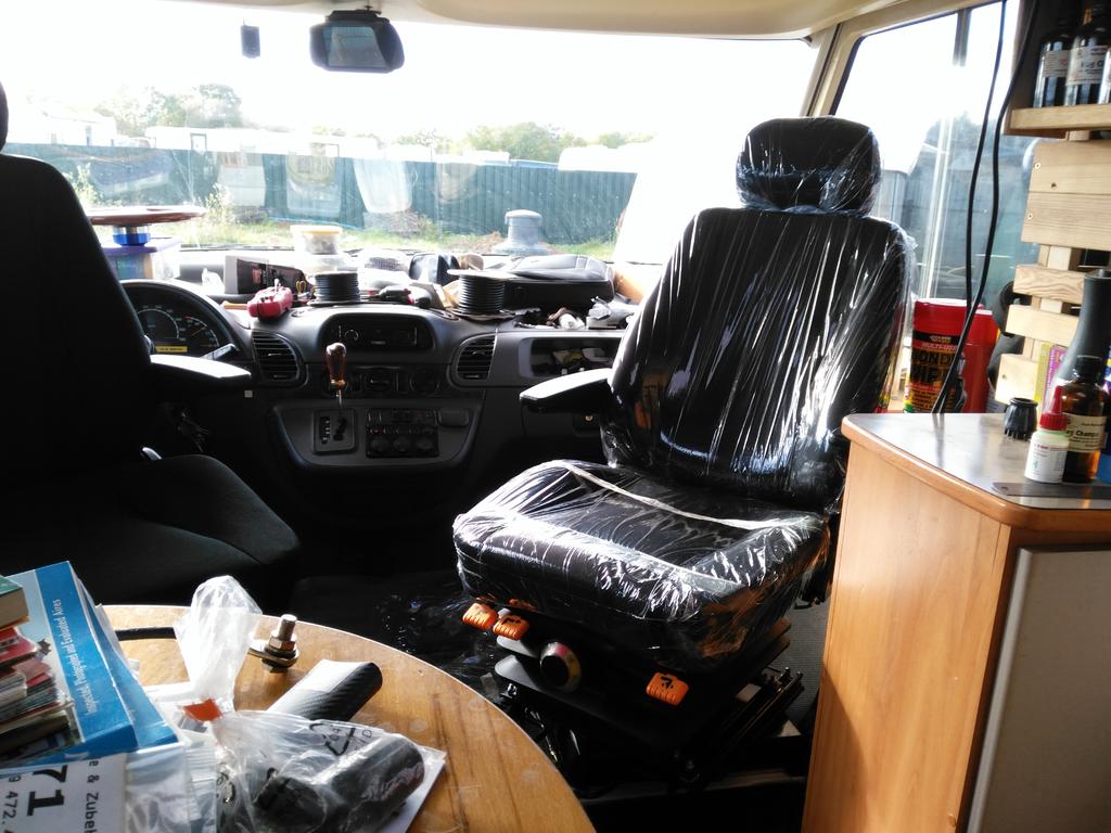

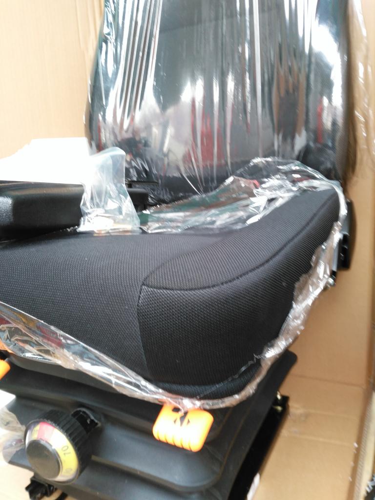

So today I took delivery of 2 of these (in black) SG10 Mechanical Suspension Seat
total for the pair was around £750 inc vat and shipping.
These have mechanical suspension, adjustable for various driver/passenger weight.
Height adjustment, tilt and back adjustments, recline etc.
Only modification that I need to do is to make up a pair of 1" flat steel bar spans to replicate the Hymer modified original seat fixing centres.
I'll be re-using the existing swivel plates and swap out the original slider/runners for the ones on the new seats.
I unwrapped one on the delivery pallet and gave it some bounce tests, the improvement in comfort over the ISRI rigid seat is huge, even when just perched on a pallet.

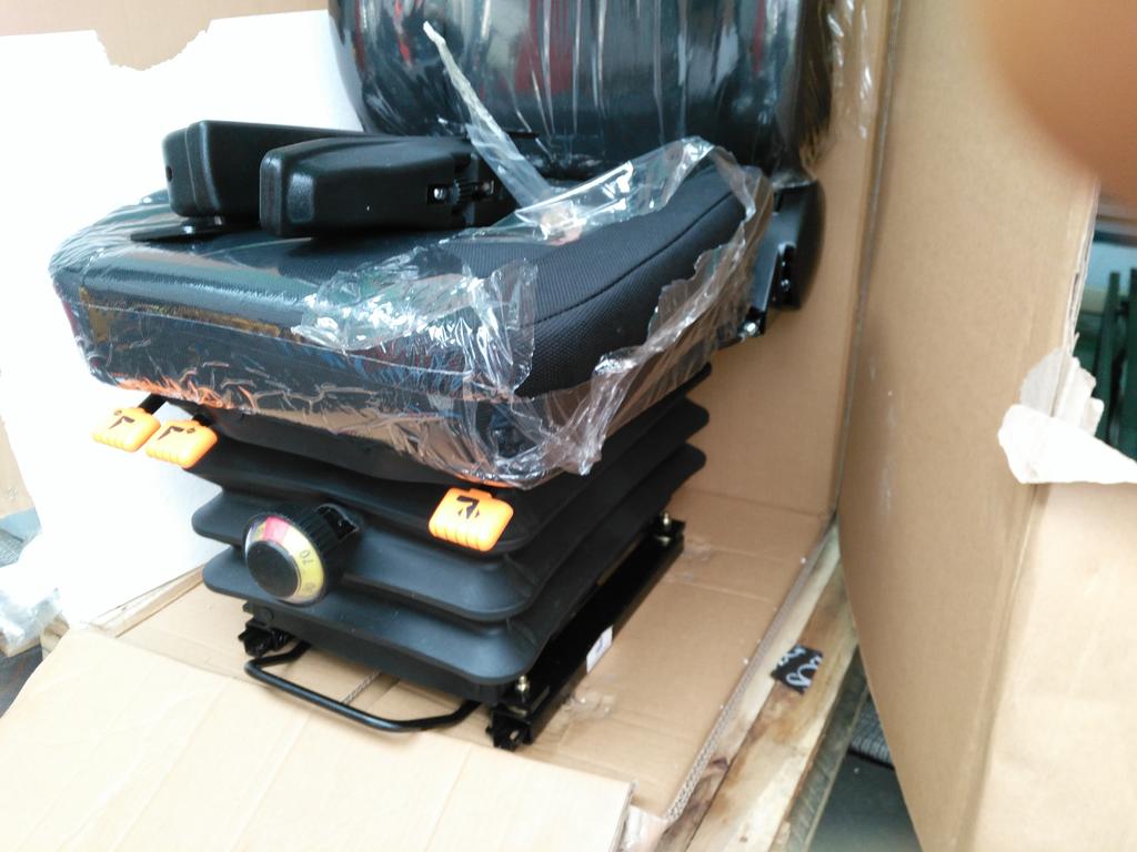

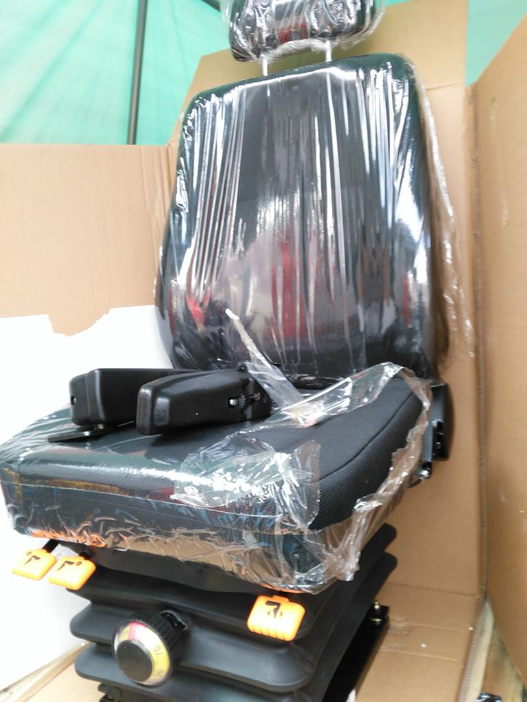

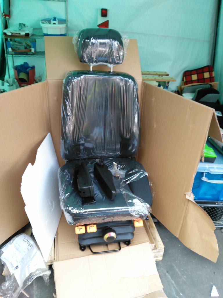

A quick preview old ISRI seat in situ, new SM10 Jennings seat on the pallet.

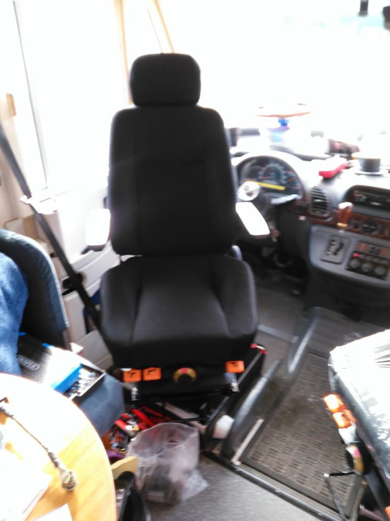

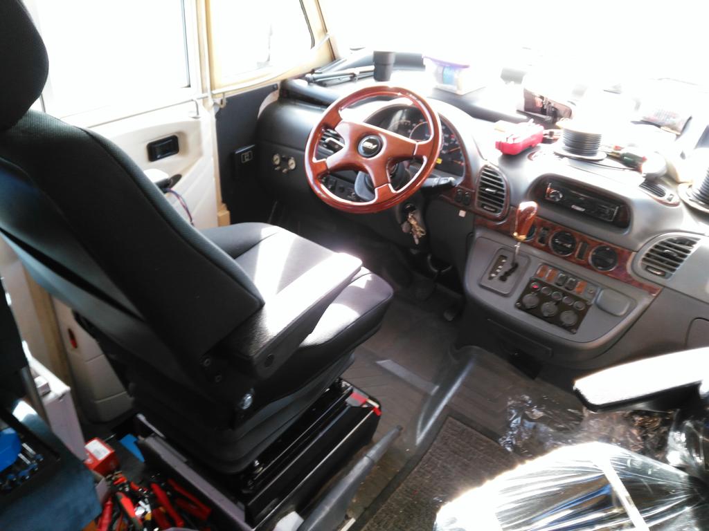

My replacements will sit on the box/plinth and increase the overall height of the seat base / arse support by about 3 inches.
This will raise the driver's view by a little, I'll be sitting slightly higher in the pilots seat. Still easily and comfortably reach the pedals.
The only mod I am having to make is to add a pair of 1" flat steel bars running left to right as the new seats are narrower at the base.
The original Hymer/ISRI seats have had a similar bar welded across the base between the lh/rh/runners.
edit: My originals also have a swivel plate which I will be re-using on the new SG10 seats, allowing me to swing the seats around to point inwards.
This means that the steering wheel has to come off each time I swivel, it has a quick release mechanism to allow this.

Both new seats Installed - some pictures
2x new seats now installed, vast improvement over the non-suspension ISRI originals.
