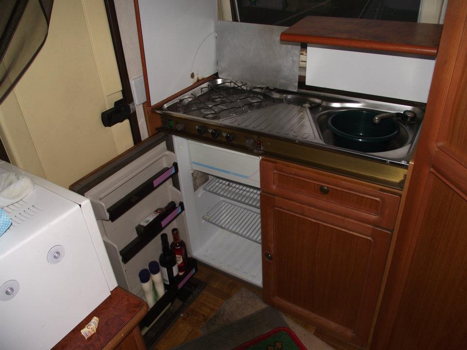

Just had a quick look and snapped a photo.
There do not seem to be any screws with caps within the fridge. But i'll persevere. Its a RM270 Electrlux..

You have to remove the hob, on top of the fridge at the back is an alloy angle bracket that seals the top of the fridge to the outside wall below the air vent and until that and the gas pipe which is behind the top vent are removed you cannot slide the fridge forward
