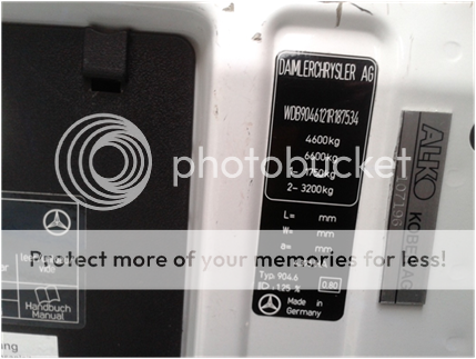

Loaded Hugo with scooter, 3/4 tank of water and fuel, chairs, windbreaks, sat dish, tools, all domestic bits except clothes and food. Sat Jan and grandchild in the back and went to the weighbridge near us. It's normally a fiver a go, but as we had three weighs it was a tenner. Results below:
Vehicle Plate Data
If you do the arithmetic I have 780kg spare on the rear axle and 310 on the front, and 720 overall. I don't really have anything to say to those doom merchants out there.....

By carrying the scooter and rack you take perhaps 100kg off the front axle so potentially you have a better balanced van it's a win win!!

Why is it a win win situation, fact or opinion?

I have to say that on the run down through Spain the van felt light on the front during the serious cross winds we encountered. I got used to it though!
The van has 300 Kg load margin on the front with the scooter on the back, a reasonable amount of leeway. With the scooter off the back the front may then have only around 200 Kg load margin, not a lot by my standards. The rear axle has plenty of spare load capacity in either condition. It's a win win because by carrying a scooter that's a plus ie a win and additionally the front axle load is reduced.
Do you reckon this is fact or opinion?
John
You have rightly noticed the tell tale signs of a light front end, and in wet conditions may well need more caution.
The vehicle when weighed had only 82% of it's permissible weight on the front axle adding further weight to the rear 1/2 of the vehicle or even further back will only decrease that percentage, steering, braking efficiency and traction will all be affected. (less tyre on the road)
Fuel usage will also reduce that %, raising the front tyres off the road surface assuming the tank is mounted just aft of the cab area.
