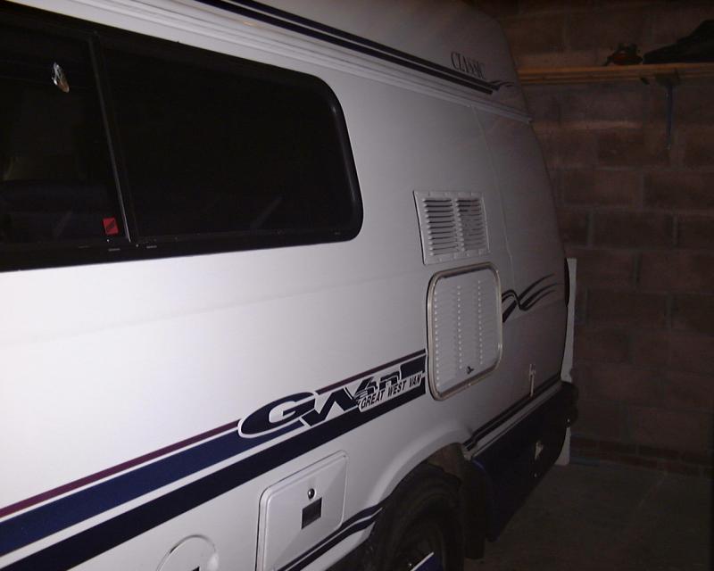

I have never seen any installations of these units other than in my own campervan and other American vans. I don't know what the Btu output of my unit is as I can't get to the i.d. plate, but it needs a 2.3Kw generator to start it:scared: (or EHU). It is obviously designed for an average living room and it is installed in a van with an internal volume of a Transit high top, over cooling is an understatement:lol-053:.
Here is a pic of my unit installed so you get the idea. aircon outside.jpgaircon.jpg
Although I resent the cupboard space this thing takes up and it can be a bit draughty, it has worked fine for 10 years!Just wondered why they are not used more in M/H's for warmer climates?
