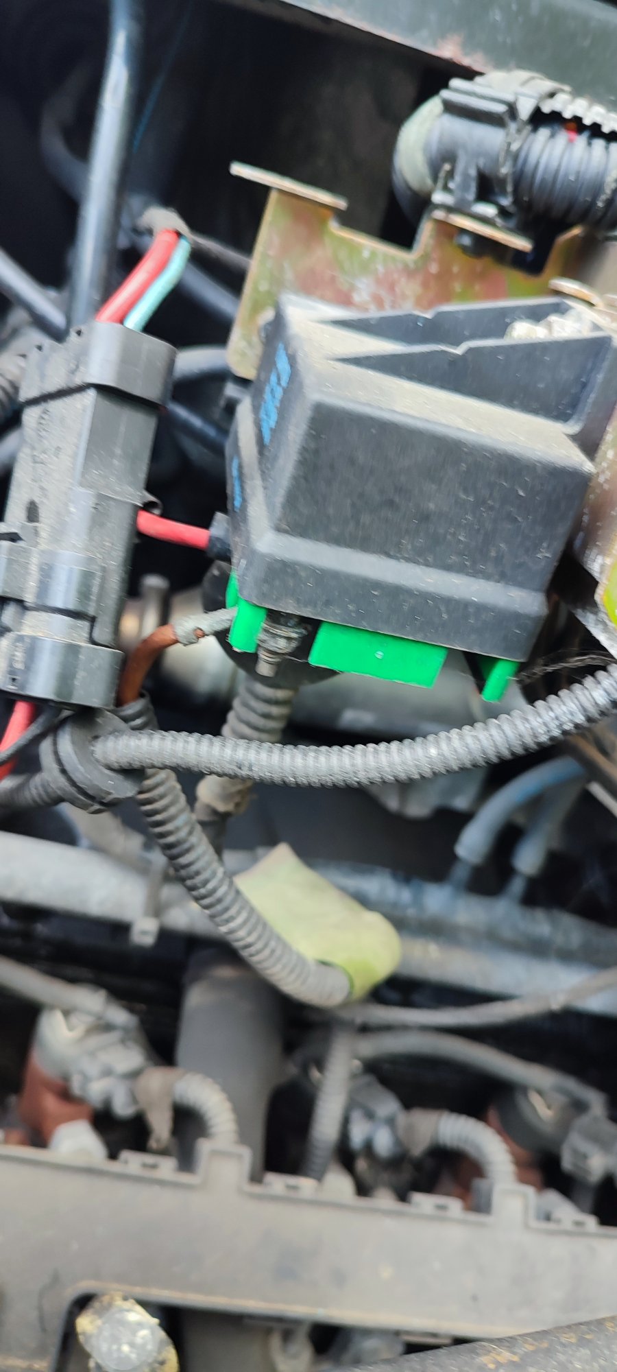

Just stopped off en route to Canterbury P&R ready for eurotunnel tomorrow. We found there was no water, pump not running. Then found that none of the lights and other stuff that's supposed to be live when the ignition is off were working. I suspect it's a relay, presumably there's one which disconnects the 12v supply to the fridge when ignition is off and at the same time allows power to the hab area - but not really sure and having looked at the collection under the bonnet I have no idea which it could be.
It's a 2002 compass avantgarde 400, engine is Peugeot 2.0 hdi.
Can anybody tell me if I am on the right track and if so which gizmo in the pic is the culprit?

It should be located under the bonnet near the bulkhead and be black in colour. There are a number of them so physically check for overheated wiring or maybe a faint buzzing sound.

The pic I posted is the cluster under a cover in the centre under the bonnet
Have you had it for a while? Are you familiar with the charger /leisure side ?
To find for sure that it is the relay you could try swapping them around. From memory they are all the same relay (you could find that out by checking the part numbers. Just remember to put them back in the original order if you have no success.
We've had the van for about 9 or so years! I've added two solar panels, one soon after buying and another last year. I've also fitted a smart Victron mains charger to replace the old unit which was no more than a power supply as was usual in older vans.
This is the first time we've had a problem
Thanks, I'll have a look at them again, I suppose it's more likely that the two black ones will be the same.

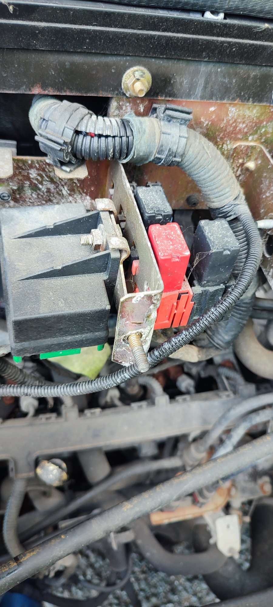

Tried swapping over the two black relays which have the same numbers, still no power. Can't see any damaged cables.
I presume that this item under its cover which is attached to the left of the relays is the split charge, judging by the thickness of the cables.
