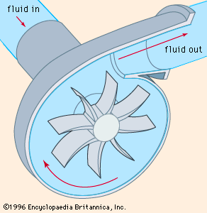

No, impeller is the correct word if it is a centrifugal pump. It is connected to the motor inside the housing and swirls the water from the suction pipe to the pressure side of the pump. Sometimes they come loose or get blocked or just seize up.

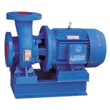

This is a big one but you should be able to recognise the major parts even though they will look different. The impeller is inside the thing that looks like a snail shell.
