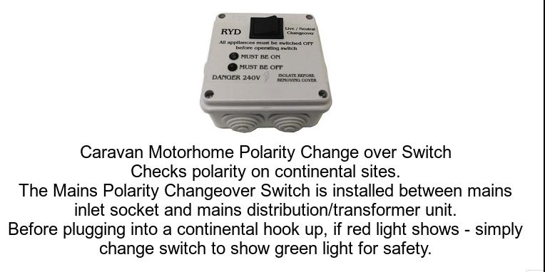

You should have a male plug on the side of van which should be able to run any 230v plugs inside, a good idea is to have a ac polarity switch over inside the van with a warning light as many sites are incorectly wired, esp mainland europe, a red warning light on the unit will tell you to flick over to get a green light, and before folk tell you it does not mater yes it does as kettles etc if falty will be live on the shell as with toasters to.

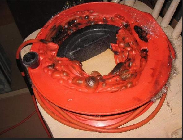

And remember to uncoil the cable out, as it if not acts like a transformer coil and will over heat or melt because it may not let the the voltage through and the current draw will rise causing heat, same as extension leads at home.
