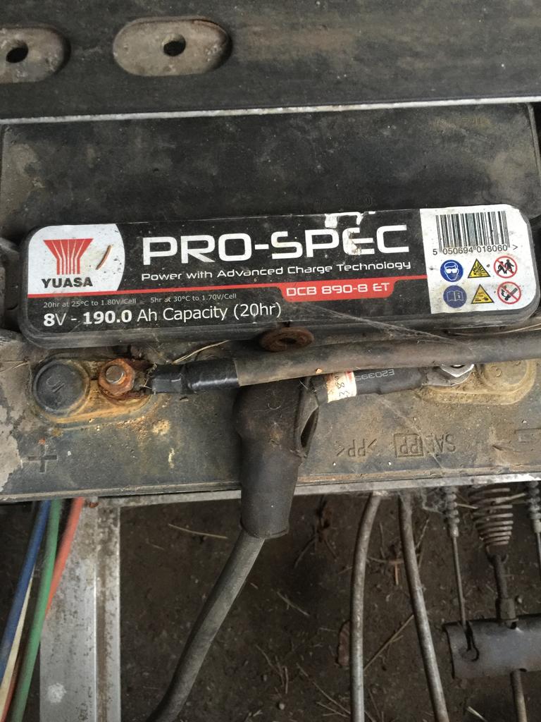

I have the daily use of any of 3 Club car Golf buggies, & This one is mine as it’s a Tipper.
I use it Daily during my 11HRs shift, & it’s got 6 of Thease Batteries

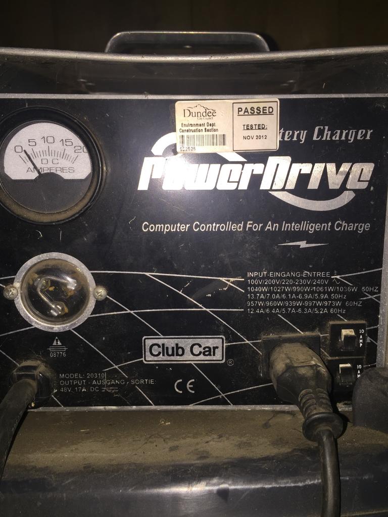

When I plugged it in on charge @ 16:00 (finnished with it & Coffee break) it can start at 18amp then fall as it charges, I took this pic at 19:00 as I finished for the day.
