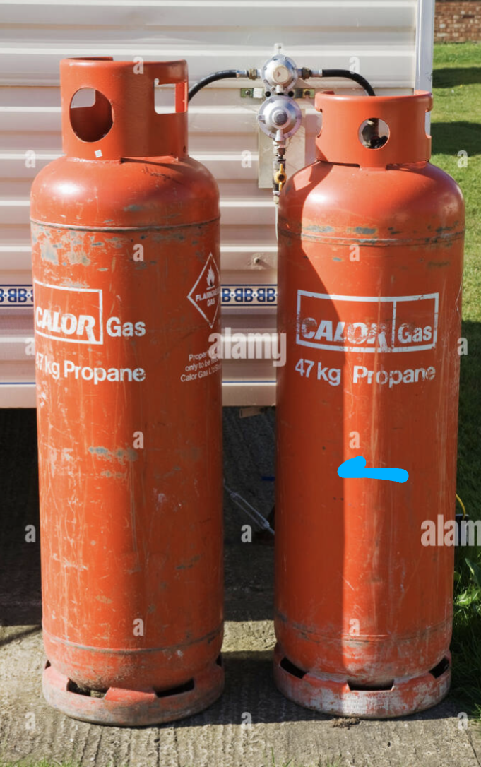

Baz, you could get a couple of those 47kg bottles outside your van......start selling lucky heather and clothes pegs.
