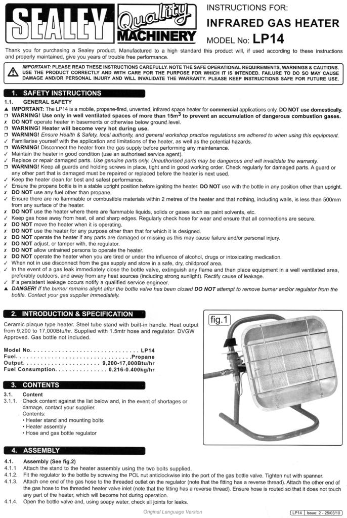

I have just bought a floor standing version to heat / dry out my garage. The instructions state the following
IMPORTANT: The LP14 is a mobile, propane-fired, unvented spave heater for commerial applications only. DO NOT use domestically.
WARNING ! Use only in well ventilated spaces of more than 15 cubic metres to prevent an accumulation of dangerous combustion gases
Warning Heater will become very hot
Further down the list
DO NOT use any fuel other than propane
I was thinking it would be OK for heat when sat outside but i do not think they are fit for your purpose.
I will try and upload the instructions / warnings if possible
Stay safe
Churchie

15 cubic metres is in van type dimensions
2 metres wide x 4 metres long which gives you 8 square metres now divide into 15 to get you minimum head height = 1,875 metres tall.
It's 15 cubic metres, not square metres. Length*Height*Width, then you need to calculate what area the fittings, cupboards, kitchen units, seating, bed etc. take up. I very much doubt you will have 15 cubic metres.

cubic metres . if your van is 2 metres high and 2 metres long,and 4 metres long---4x2x2 is 16 cubic metres. i just wouldn't

It also states in the instructions must be at least 2 metres away from anything flammable or combustible that would also make things difficult in a van.
