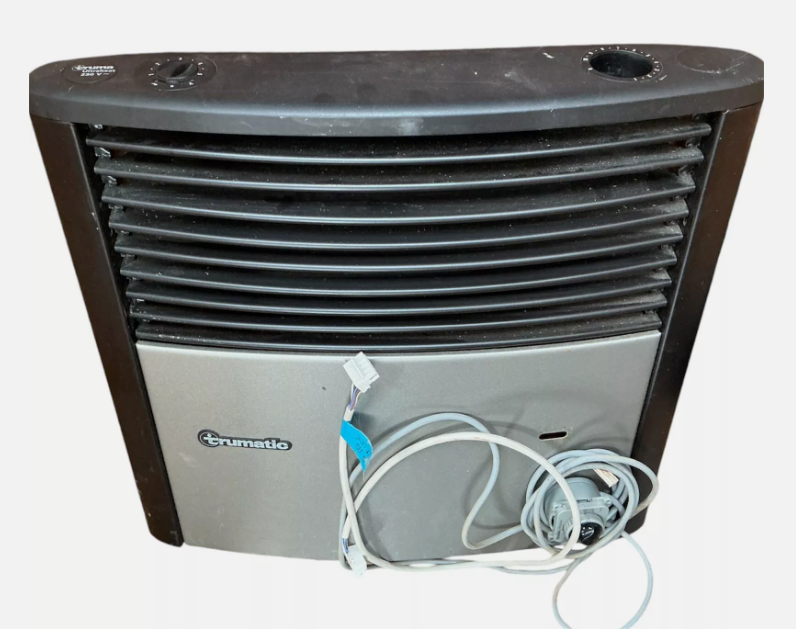

This is the one we have, I know what Barry means about lighting them, we have had the same model in quite a few of our vans, but the one in the Sienna always lights the first time and it never squeaks or rattles on the road so I leave it alone, previous ones have been a nightmare.

What type of heater do you have?
If it's a Truma like Pudsey illustrated you don't have to use the built-in fan.
I have a USB rechargeable fan that is positioned to blow downwards across the front. This distributes the heat brilliantly and without the heat losses through the ducting.
Hi. It was a carver heater in last van that was excellent.But a combination heater /water boiler in current van that I find so poor .
Hi everyone.
Was just wondering why all vans seem to have blown air heating instead of balanced flue fire ,in our last van I could light the fire and the whole van would be toasty in less than ten minutes with blown air it takes at least half an hour before getting vaguely warm . And yes I have checked all the pipes are connected.Perhaps it’s just me but certainly preferred the old system.
If yours is a Truma say, it needs the vinegar treatment to clear the build up of chalk on the heat exchanger which effecting performance. Is the regulator and or gas valve letting enough juice thru? If you put the burners on on the hob then turn on the boiler, do the hob flames dim? If so it's ur regulator - happened to me after picking up dirty autogas in Norway.
