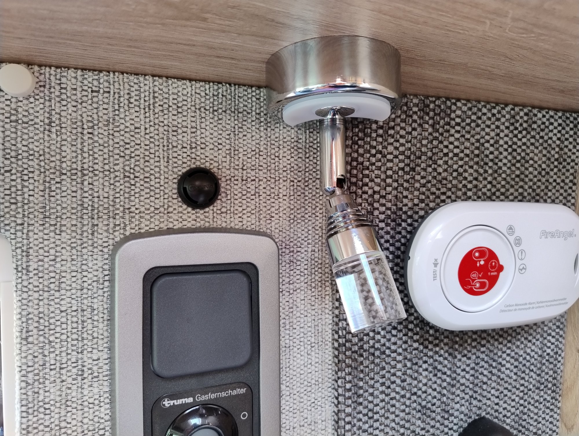

My lovely new van (Devon on a Boxer), is blowing a 10A fuse on one of the habitation lighting circuits. Replace it and it blows instantly. It's a 6- 7 hour round trip to Devon Conversions in County Durham and I'd rather not do that if at all possible. However, where do I start? I imagine it's a needle in a haystack job. Should I even try? Electrics definitely not my strong point.

Thanks. That's v encouraging on one level. However, it's not the situation where there's an easy bulb to pull. I can't yet see how to even disconnect these little babies, each with a low ambient light and spotlight.
Are the lights turned on when the fuse blows if not then the fault will be in the circuit.
If this is the case I would contact the dealer. But to remove these lights unscrew them, and you should see an inline connector. Simply unplug them. Also the fuse may only blow when certain lights are on, if so you know the rest are ok. If it’s the wiring it could be a compressed cable, and this can happen when fitting the light, look for any signs of compression on the cable when removing the light. Simply removing the compression should solve your issue.
Look dangly, id bin them and fit flush led units which are easy to change bulbs in, see 3 up front.

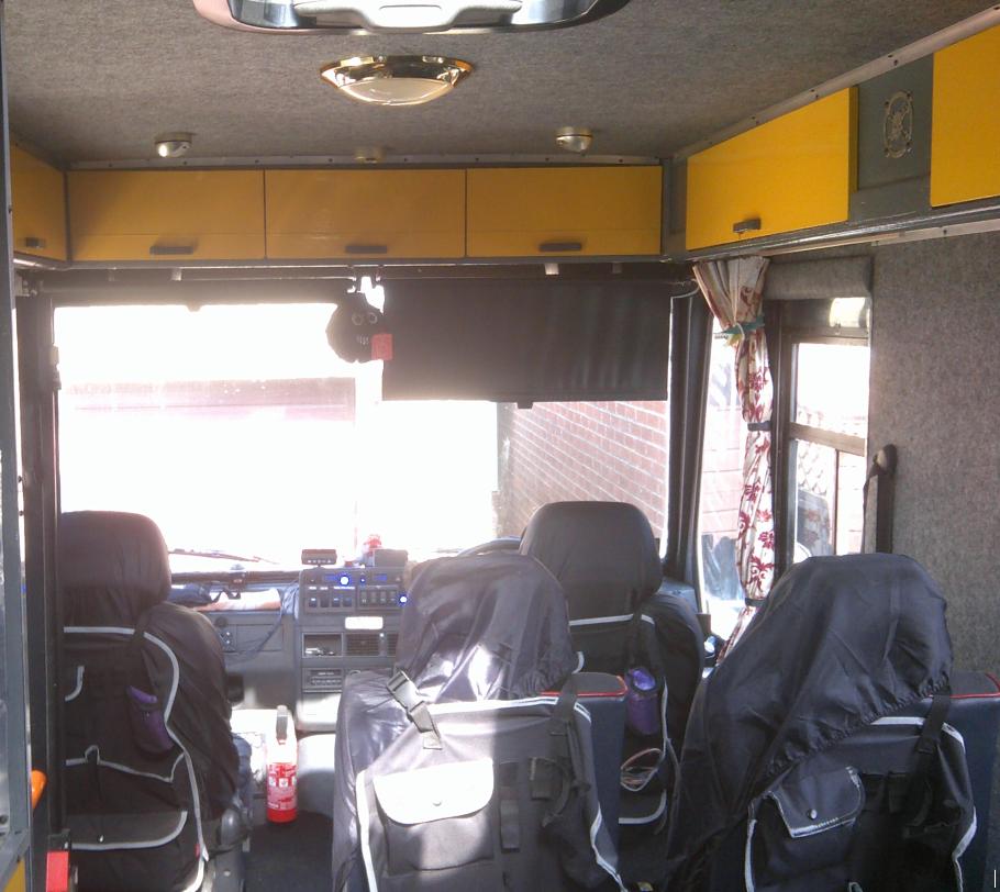

With all these cables in bad places and problems with factory built vans i now am glade i built my own, along with the money i saved doing so, 12 years running for 6 grand cant be all bad.

All I can say is that I'm happy for you Trev in your smugness.
