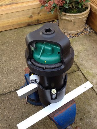

Anyone here had the problem? Also is there a water dump valve on the fuel filter on Fiat 2.3 130 BHP X250.
On my x250 the filter drain is white & on the rhs half way up the filter bowl needs a screw driver to undo it when you undo it you need the ignition on and the fuel is then pumped out the bottom of it.
40k with mine only on French diesel never seen any water when I've changed the filters CA_02061422053884-M.jpg
