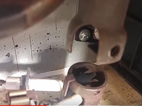

A quick fix I've done in the past.Turn fridge off.If you have a bicycle pump handy direct the adapter towards the jet and blow out the bits that have probably dropped down from the exhaust.

When you can take the windshield away from around the jet,as said.Probably have a chunk of carbon lodged there as in the pic.
One screw removed lowers the jet so you can see more clearly.
Don't poke anything in the jet ,you may make the problem worse.

The windshield cover has two screws, one has to be removed but there is one at the rear which is in a slot and can just be loosened, the cover will then come off, the burner assembly has one screw at the front but the assembly can be tight and needs wiggling
