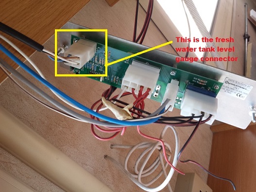

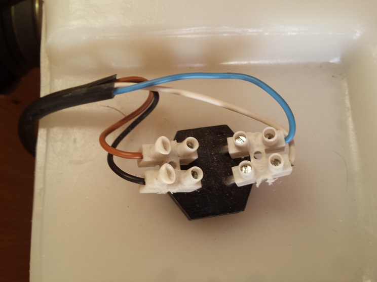

Hi been experiencing problems with my Fresh Water level sensor gauge. I own a 1997 Fiat Ducato AutoRoller. All started when I had to redo all the wiring as it was in such a mess and very dangerous. Everything else is all sorted and works as it should, apart from my the level gauge on my fresh water tank.
I'm a bit confused to how it works with regards to needing power. As there is only 1 black cable (sleeve with 4 different coloured wires within it. This runs from the control panel to the tank via a connector mid way (connector is just a 4 way male and female multi plug connector. I have connected it up as it was but it doesn't work, always shows empty even when full or three quarters full. And just recently some strange red light came on, on my control panel where the water level gauge is. Not sure what it is, looks like grey waste water tank by the picture.
If anyone has experience of fitting and installing water tank sensors, level gauges etc. Any advice or pointers would be very welcome.
